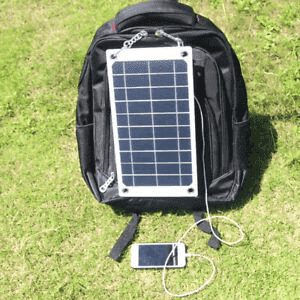

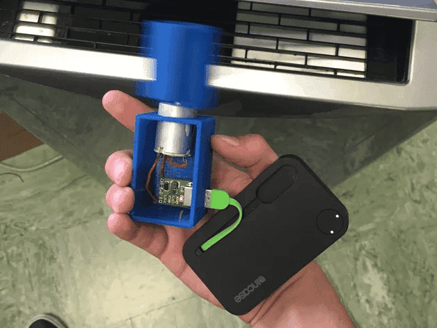

Well the "goal" is to attempt charging a 3.7V 350mAh battery with a turbine with a blade diameter of approx. 12mm. Obviously this is very small, so I'm curious if creating a teeny tiny generator would be viable.
OK. That is possible if you have enough wind. However, it would be far easier and less expensive to do it with a solar panel. Below is a picture of solar panel phone chargers sold for campers.
And below is a picture of a wind powered phone charger.

My experience with small marine wind turbines on boats is that they produce almost zero power until the wind increases to the range of 12-15 knots. Hence @berkeman 's question about wind speed where you are.
Likes berkeman
12mm? You won't make any kind of energy with a half inch turbine. The key with wind turbines is swept area, and you need a decent amount of it to make any kind of reasonable power. What's your application here - what are you trying to accomplish exactly? You could probably charge that battery at a reasonable rate (1hr charge time) with a turbine in the range of 10cm diameter or so, assuming a decent wind source (~10m/s), but that seems like it's probably not the ideal solution for a compact energy source given the unreliability of wind (especially down near ground level).
