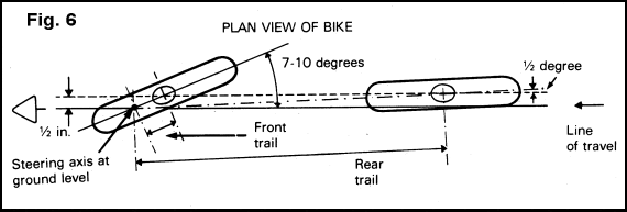

Even when not moving forward, the act of turning the steering moves the balance point on the ground sideways, back under the centre of mass, which corrects the fall. The magnitude of that movement is determined by the steering geometry and the curve in the front forks.
Turning the steering while leaning the bike, can change the height of the combined centre of mass, as is done by sitting up or leaning forward. The combination of those moves seems to maintain balance, most of the time.
Notice how, to turn right, you first steer left, then begin to fall right, until you are going in the right direction. The rider is forever falling, and correcting their fall, towards their destination.

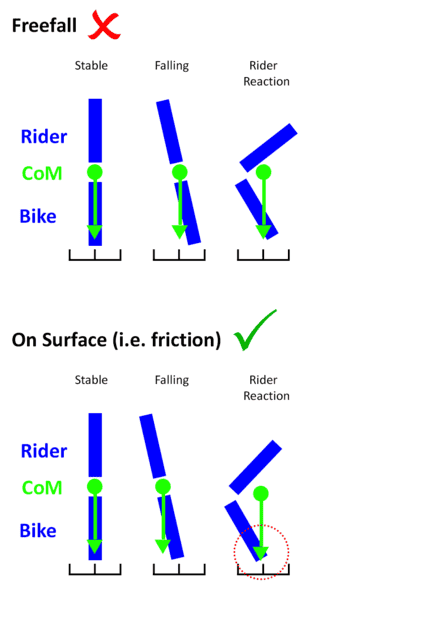

Jordi Heguilor said:
The action of the rider moving their body right seems to me would produce a left force on the pegs,
Consider what the rider-and-bike wants to do when this happens. It wants to pivot about its centre-of mass. And it could - if it were in free fall.
But because the wheels are in contact with the ground, it actually pushes the whole object to the left, which is what puts the wheel back under the CoM.
Please, see how the trails allow the rider to move the COM of the chassis over the line between both contact patches, which is the imaginary line vertically over which the combined bike-rider COM should remain:
https://motochassis.com/Articles/Balance/BALANCE.htm
This assumes the rider is turning the wheel to stay balanced. I'm not sure that's necessary. A rider can balance on a bike - with the handlebars and front wheel straight - and still balance indefinitely. (I think!)
The latter diagram seems to be backward. The rightward push by the feet on the ground yields a leftward impulse on the body by the ground. That drives the center of mass even farther left.
If you are falling left you want to bend to the left.
Watch a person falling off an edge. They will windmill their arms in the direction of the fall. Because that is the correct thing to do. You want to sink as much angular momentum as you can into your arms while you work on getting your body back on the safe side of the edge.
If you think in terms of the angular momentum of the falling body about its feet then no amount of pushing left or right can change the body's angular momentum. The moment arm is zero. No torque.
The point of pushing left or right against the ground is to manipulate the position of the body's center of mass. Then gravity can provide an external torque that will cancel and then reverse the angular momentum of the fall.
