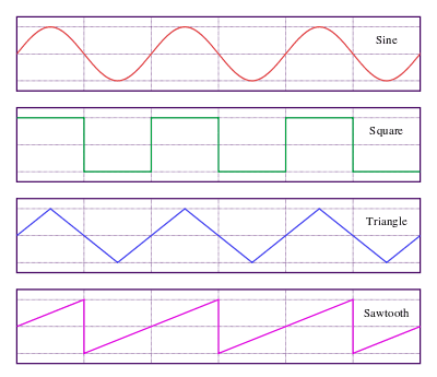

Like these in the photo, for example the square shaped
Heh, well, actually all of those are superpositions of sine waves. For example, the square wave is actually a superposition of all the odd-numbered sine wave multiples of the fundamental frequency of the square wave, with descending amplitudes as the frequency increases. But that has nothing to do with polarization, nor with emission and absorption of photons.
So the answer to your question is, no, a single photon cannot have those kinds of waveforms; but multiple photons traveling together can, and you can add them up and treat them as a single wave, and you'll get the same results as if you treated them all individually.
Likes physics user1
