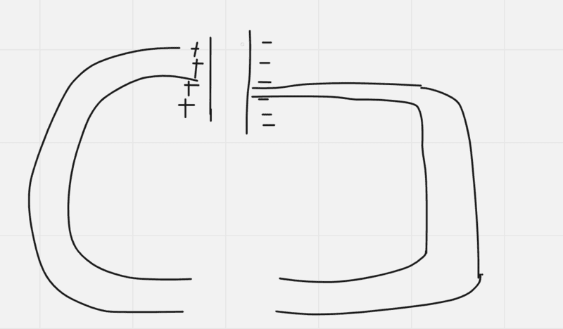

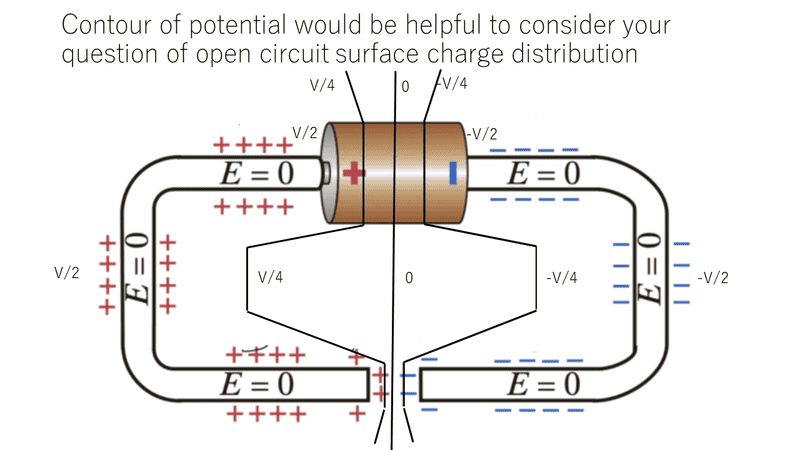

Recalling that a capacitor or condensor is a pair of facing metal plates, we may restate your case as why condensor or capacitor is charged when connected to battery ?
anuttarasammyak said:
Recalling that capacitors or condensors are a pair of facing metal plates, we may restate your case as why condensor or capacitor is charged when connected to battery ?
Well, To not take things far and more complicated, I am only asking what I am asking which is you only got battery and wire. I did not mention anything else.

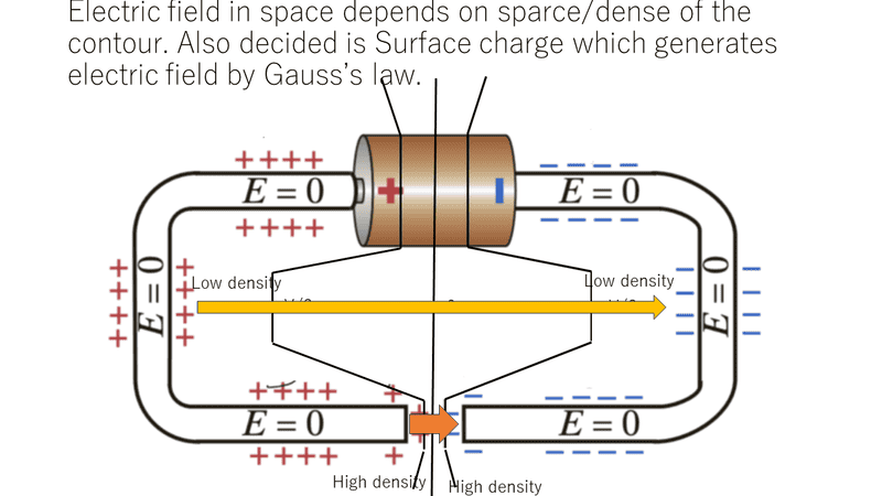

@Dale I asked this(completely different one) on stackexchange but yesterday you enlightened me that surface charges are what makes E constant. So I went ahead and thought the above. If you got time and nerves to bear with my horrible knowledge, I would appreciate it. It is a big text but should be easy to read. Scroll up to the first post here(there should be one theorem - my assumptions and then 3 questions).
Big thank you 🙏
The article http://amasci.com/elect/poynt/poynt.html might be of your interest. However there is resistor for the closed surcuit, the discussion is same for open end and plus wire and minus wire form a condensor to store energy between. Free electron excess or scarce front goes with light speed starting from the connection to battery.

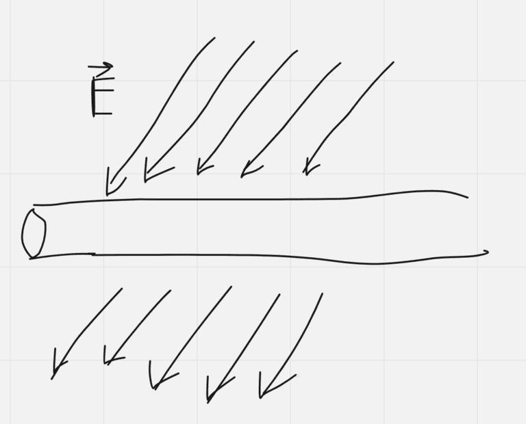

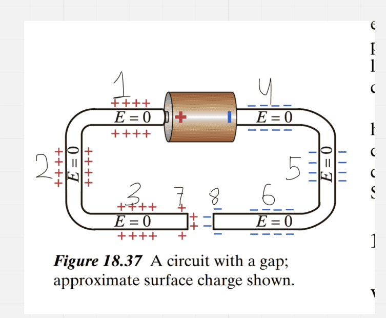

Q1: I have been thinking about your example of uniform E field near the wire. If we imagine that wire is put horizontally, and E is uniform horizontally, then I understand the surface charges situation as I explained in my previous reply. but now imagine E is not only horizontally, it also has y component as well. The funny thing is when electrons start to move(left - direction of field's force), they also move bottom(let's say E field is above the wire only) then, when electrons move, they move left/bottom and they continue like this - when they get to the end, they will be on the bottom surface only. when new electrons come in there, they repel from electrons already present on bottom surface, they then try to move backwards, but they can't also do that as new electrons come in so they repel from them as well(in my opinion - they would repel more from these new coming ones), I don't think they try to move up because they're already bottom and the repelling force is not upwards - even if it was(which is not), E wouldn't let them go up. So we kind of got a situation where electrons would only accumulate on the below surface(not the upper surface) - how nice is this ? haha
Q2: I think I have to confirm something so I understand it very well(I believe this is quite important). So if we imagine only one stream of electrons move to the end(let's say they're 20 electrons), when they move to the end, they will still end up on the surface. In the last example, I said this is due to the fact that new stream of electrons coming as well and their repelling effect doesn't let them move to the opposite direction to the wire, so the try to go to surface. But even if there's no other stream of electrons and this 20 electrons got to the end, now on the end, there's excess of electrons(these 20 and the original ones as there were already atom's original ones) - So these 20 try to move in the opposite direction due to repulsion from original ones, but E field doesn't let them, so since they can't move to the right, from those original electrons, they experience perpendicular component of E(this is E field of original electrons) and still go to the surface. I wonder if we follow this example, how strong E(our uniform field) must be so that it doesn't let these 20 electrons move back a little bit in the opposite direction. Note that if it's not strong enough, repulsion effect from original electrons will be bigger than E field and it will win hence we won't necessarily have surface charges (well we might still have as repulsion effect won't be only horizontal, but in both directions and might end up with surface again but most likely, we won't have surface charges on the very last end of the wire, but some distance away from it). Do you follow this example ? agree with me ?
Q3: So on the surface, from the last end to the wire to the below part, we won't have continous charge distribution as when first electrons got to the last end's wire and new electrons coming in due to E field again, E wants to take them to the very end, but these electrons also feel repelling force from the wire's last end's surface electrons. So they will kind of maintain some distance from them I believe, but now these new electrons will accumulate again in a different region(not on the very end, but a little bit distanced away from it) and then they will experience the same effect and go to surface. That's why I believe we don't have continuous distribution of surface charges. So I believe that unless E field(our uniform one) is strong enough, repulsion effect might override it and we might get a very different case(who knows what). Agreed?

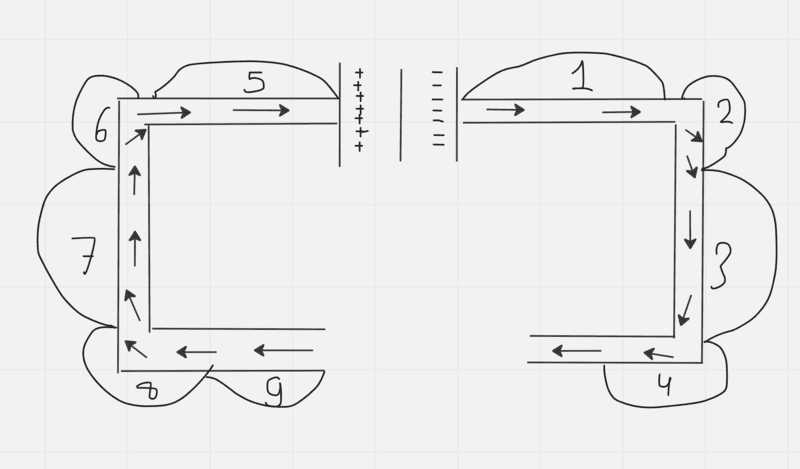

--- Now time to connect to battery ----- The Q4 has a) and b) part.
Q4: When we connect wire to the battery(circuit still open), now E field of positive charges of terminal do the same thing as our uniform E field was doing. I attached the image. (let's focus on the positive terminal's wire side - when I mention wire, I mean that part of the wire). In there, if we look at positive terminal and its side of wire, what exactly is going on ? I believe battery's positive charges attract nearby free electrons, and the region where free electron were, now contains positive ions which try to repel from each other. and they also start repelling from battery's positive charges.
- a) What I wonder is if these positive ions start moving to the end wire or they immediatelly get to the surface that is close to the battery ? but it's hard to imagine they would get to the surface there as even though each ion tries to repel from each other, they also get repulsion from positive charges of battery. you might say that E of battery there is horizontal, but at that region, wire starts to bend where E also is bent. So these ions might be moving below before getting to the surface. Hard to imagine here the flow. This is what I don't get, but I understand how we would get surface charges near the end of the wire. When electrons got attracted to terminal, ions appeared and they start attracting electrons from the next part of the wire and so on and forth. This happened even for the last end of the wire - electrons from it also start moving to the positive terminal's direction and we got left with ions there. So they start repelling each other, but funny part is they couldn't go to the positive terminal's direction as E direction on the below is to the right, so they're stuck and go to the surface.
- b) when electrons got attracted to the battery terminal's charges, what happens to these electrons ? do they get combined with positive charge of battery, making them neutral ? but if this were the case, battery would soon end up having all the neutral charge on its terminal. but if this is not the case, where do electrons go then ? do they actually get attracted to the battery's positive terminal in a way that positive terminal's charges just stay where they're and they just suck in electrons or they meet halfway to the electrons ? but I don't believe they would meet half way as by nearby electrons, we mean in an infinetisemal region close to terminal, electrons would be there(original free electrons), so battery must be sucking them. Not sure.
What do you mean by this?
You are forgetting that where the mobile charges leave there is a surface charge of the opposite sign left behind. This is automatic. You automatically get charge accumulation on the opposite surface too.
Yes, you will have surface charges. And yes, it is not necessarily the exact end. In electrostatic induction you tend to get the most charge accumulating on portions of the surface with a small radius of curvature. This is why lightning rods are sharp. But surface charges do spread out as much as they can.
It is still continuous, but it is not uniform.
Yes.
Yes. While the circuit is open the wire acts as an extension of the terminal. The charge will accumulate on regions of high curvature.

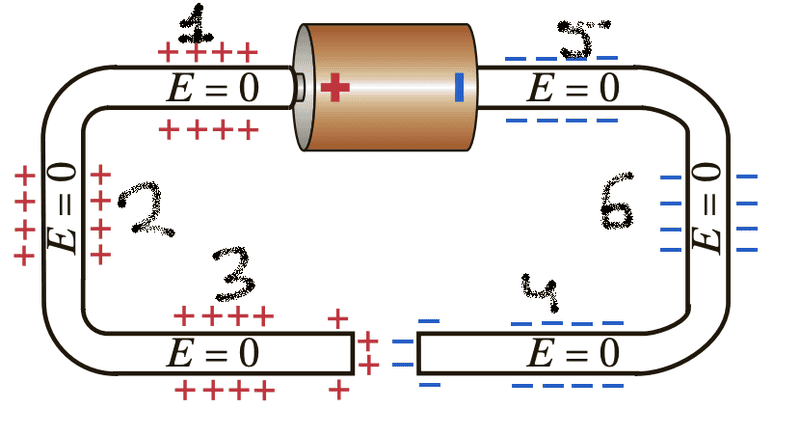

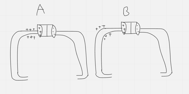

@Dale
Well, if you imagine E is uniform but with an angle near the wire, (E is tilted so it has x and y component both). So the force is to the left and to the bottom both. If so, electrons not only move to the left, but to the bottom as force is taking them below as well. This is why I said we won't have surface charges on both surface, because even if electrons want to get on on the top surface, they're being taken by the force to the bottom as well. So If E is strong enough, it won't let them get on the top(up) surface. It's true that lots of electrons will start repelling from new electrons coming in to the left and they will start repelling from each other and they would want to go to the up/top surface as well, but if E in the y(below) direction is strong enough, it will override the repelling force and take them to the bottom surface. The first image attached shows what I mean by E field as tilted. Even though, you're right that leaving mobile charges means opposite sign charges are produced, they also go in direction of the force which is to the left and below. Thats why I said we will have surface charges on the below surface.
With Q2, What I meant was if external E is not strong enough, electrons that accumulate on the very end of the wire mightn't necessarily go to the surface right away. This is due to the fact that repulsion effect between excess electrons can cause them to move backwards(in the opposite direction of their movement). The reason they might be repelled backwards is E is not strong, so repelling force > E, so electrons as they repel from each other(some go top, some go down, they also repel horizontally, as E is not strong enough, so some also get repelled backwards). What this results in is not necessarily we could have surface charges on the very end, and the density of surface charges could be less, but if E is strong enough, density of surface charges will be higher(more charges would go to the surface). I think that should be correct assumptions ?
With your words, what's the reason surface charges on the last end of the wire have bigger density and as you get far away from the end of the wire, density gets less and less ? in copper atom, would all of the valence electrons(each atom has 1) would end up on the surface or some of them might not ?
With battery connected to the wire(circuit open though), I think on the positive terminal, surface charges accumulate right away on the surface closest to the terminal. On my second attached image, we should have option (A) occuring. I guess its electrons (since they're closest) to the terminal, they right away lose valence electrons, so we got ions produced at the quickest time and at the closest to terminal, hence their repelling from each other make them on the surface, since positive ions accumulate this fast, now, it could be them that's attracting valence/free electrons from the later part of the wire. The place free electrons leave from the later part of the wire, that place contains again positive ions and they again form surface charges. What I don't get though, the electrons that come from the later part of the wire, do they get closer to the ions(the ions that got on the surface - they were closest ones to terminal) ? If so, these ions that were on the surface near the terminal must become again neutral ? but if so, then their E field mightn't help with E = 0. or do these electrons get to the positive terminal's charges ? but note that, when these electrons move from later part of the wire to the terminal, they first have to meet the positive ions that are already on the surface(on 2nd image, option A shows these ions) because these ions also attract them and they're closer. So that got me thinking if electrons jump into them, then they become neutral and this would not cause E =0 in the wire, but if you say they still get to positive terminal's charges, then how ? why they're not attracted more by ions(surface charges) ?

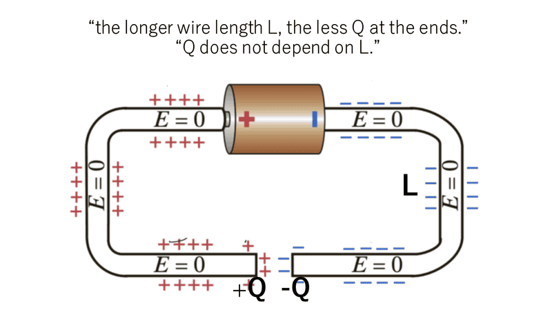

Well, you can say it all you want, but it isn’t so. You will get most charge on the ends because the curvature of the surface is highest. But some will be on the top and bottom too.
Consider that the wire is pretty long and straight and that we are looking at a part of the wire in the middle (meaning the ends are far away). Now suppose that there is no charge on the top or bottom, only the ends, a positive charge on the left and a negative charge on the right. This produces a field which cancels the left component of the external field, but does not cancel the vertical component. So by Ohm’s law current will flow from the top surface to the bottom. You will get positive charge on the bottom and negative charge on the top, canceling out the vertical component of the external field.
The strength of the E field doesn’t determine where charges accumulate. It just determines how much charge accumulates. If you double E then you double the surface charge density. You do not change its location/distribution.

@Dale
I've read the link you shared, but there's something that still bugs me and maybe due to article complexity, maybe I didn't understand it but it was still written in it.
As far as I understand now, when battery is connected to wire(where wire ends are not connected - circuit is open), there is electrostatic equilibrium which means E(net) = 0. At this situation, the surface charge density throughout the whole wire is uniform(maybe a little bit more at the bend place, but it's not much). "Uniform" means it's the same charge density everywhere, but once we close the gap, surface charge density at different places adjust(not uniform again) and we got E > 0.
on my attached image, I draw some regions so easier for us. Note that drawn lines are not E, but force directions for electrons caused by battery dipole
So instantenously, somehow, we should get elecrostatic equillibrium here where surface charge densities is uniform everywhere. Electrons from region 9 move to region 8. So region 9 now has excess positive charges which start repelling from each other and move to the surface of region 9. Same happens for region 5, as its electrons go to battery and we're left with excess charge of positive. But here is my question. When electrons of region 8 moved to region 7, you might think region 8 got left with net positive, so it should have positive charge on the surface, but at this very time, electrons of region 9 would come to region 8 and region 8's net positive would again become neutral. So until electrons of region 9 also leave region 8, region 8 will not have net positive on the surface. But we know that electron speed is very slow. So since this equilibrium is reached instantenously, I don't think saying that region 9's electrons have to also leave region 8 to have net positive on region 8's surface. but then are we saying region 8's electrons leave the region 8, which causes region 8 to have net positive on the surface, but then when region 9's electrons get to region 8, wouldn't these electrons make region 8's surface neutral again ? I hope now you understand the backbone of my question and also, electrons kind of must be going into the surface of region 8, due to direction of force in there, but they don't.
Note that this is true inside the wire. At the surface there may be a non-zero E field perpendicular to the surface.
This is incorrect. I am not sure what leads you to believe it. Could you explain your thought or what in the paper made you believe it?
It is not instantaneous, but it is quite rapid. The paper describes the DC situation, but not the dynamic transition to it.
Please don’t do this. Don’t focus on electrons. Focus instead on current ##\vec J## and charge ##\rho##. Note that both of those show up in Maxwell’s equations, while electrons do not. Focusing on electrons is not helpful and usually not correct.
So, instead of looking at electrons, let’s look at current. We have in the wire current flowing the opposite direction of your arrows.
Where current starts we get negative charge accumulating, and where current stops we get positive charge accumulating. Where current just passed through there is no accumulation of charge.
So here you have current passing through 8, 7, and 6, so no accumulation. Current starts at 5 and ends at 9. So you get negative accumulation at 5 and positive accumulation at 9.
Note that although there is no net accumulation of charge in 8, you do get a little bit of redistribution of charge to direct the current around the corner. This leads to the charge distribution shown in Figure 8 of the paper.
@Dale
You're referring still to the case when circuit is open, right ? I'm currently only interested when circuit is open. So I agree, current starts at 5 and ends at 9. but then, you say: "you get negative accumulation at 5". But we know there should end up positive charges on the surface of region 5.
What I'm trying to determine is how we end up with positive charges on the surface of all regions(5,6,7,8,9). If you're saying we don't, then at
(The link is with timestamp and you can clearly see the open circuit there and all regions on the left side has positive charges on the surface). I couldn't find the exact figure of this in our paper.
I'm thinking in terms of electrons because if I think in terms of current, it even gets confusing more. Even if we say current moves from 5 to 9, (forget about right end - negative terminal for now), then i can't explain the positive charge on the surfaces on 5,6,7,8,9 surfaces.
I said that based on the current you drew because I thought that was the part you wanted to focus on (since that is what you drew).
You cannot get those with the current you drew, even reversing it. Your drawing neglects the small currents that briefly flow across the wire instead of along the wire.
To see those, use the method in the paper to determine the final charge configuration. Also draw the initial charge configuration. Anywhere that has increased charge was a place where current ended, and anywhere that has decreased charge was a place where current started. Current just passed through everywhere else.
Again, look at Figure 8 in the paper. To get this charge distribution there was a small brief current from left to right across the vertical section and from top to bottom across the horizontal section.

at 14:31 show the same explanation but tricky, it doesn't explain what I'm asking - how unlucky).

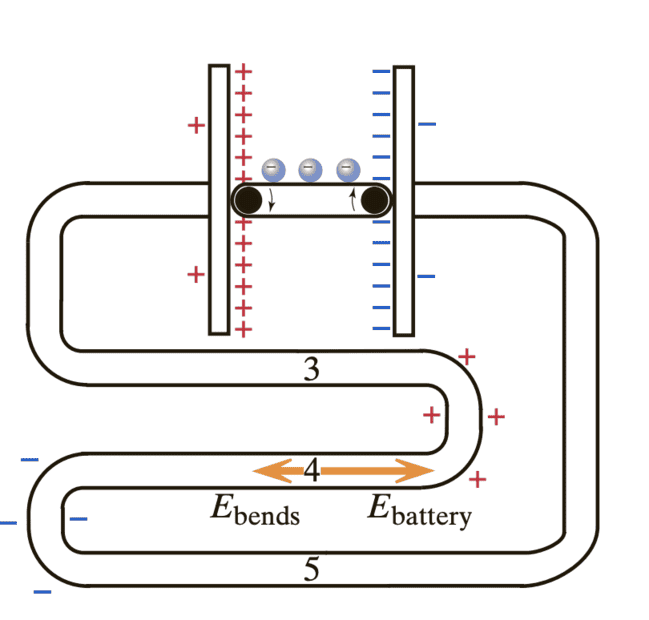

Though, one thing is still not clear as how before circuit is closed, positive charges appear on the surface of the positive terminal battery. They only show the example on the bends(image attached). In this example, I understand it. At every point in wire, electrons move to the left, when electrons move from region 2 to region 3, my question was why don't we have excess positive charge in region 2 and the answer is simple, in that time, electrons from region 3 move to region 2. So electrons of region 1 occupied the space of region 2's electrons. This goes on for region 1 as well as region 0's electrons occupy the places for region 1's electrons when they move.
On the attached image, it's all clear. but I'm trying to now see the case of open circuit and why positive charge ends up. On my second attached image, on region 1, why we get positive charges on the surface. I get that electrons start to move to the positive terminal and you might think when they move, they leave excess positive charge, but my argument is when first stream of electrons moved, their place was occupied by the next stream of electrons as this process is so fast.
I think the explanation I come up with is in the positive side wire, E is different magnitude everywhere, stronger closer to terminal and more you go away, weaker. So when the closest electrons get sucked in by the battery's positive charges, the next stream of electrons - they move - but they actually don't reach the space (due to feeling weaker force) that first electrons were occupying. So because of this, the first electrons that left the positive charges behind, those positive charges are still alone(next stream of electrons didn't reach it even though that next stream of electrons moved closer to it), so since they're alone, they have enough time to start repelling each other and distribute on the surface. Not sure if this is absurd.
I don’t think that either of those images are accurate. I would be a lot more comfortable if they seemed to be rigorously derived.
Do either of them claim to be the result of an actual calculation or mathematical derivation?

gionole said:
It is true that their images might not be the 💯correct but to me, it feels easier to imagine and I think they are giving intuition by those images. I am sure you think the paper you linked is easy, but to me, it is harder.
The problem is that they show the positive side having only positive surface charges and the negative having only negative charges. I don’t think that is right. So you run the risk of building intuition about a false situation. Once intuition is built incorrectly it becomes more difficult to unlearn.
The paper may be difficult, but you can use the pictures confidently even if you don’t use their methods. The surface charges are calculated rigorously.

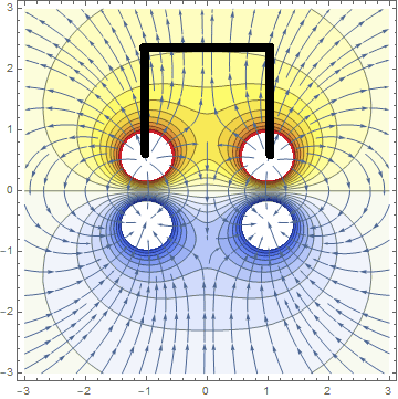

So here is an image of a quadrupolar potential like you will get in your suggested arrangement. Notice in the horizontal wire that there is an E field directed vertically. That will lead to positive charges on the top and negative charges on the bottom.
I am not certain this is correct, but it makes me highly suspicious of the drawings.

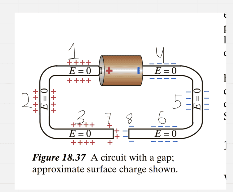

I am willing to only look at the correct pictures as you suggest. One thing I'm worried about is I wanna know the surface charge density in different regions while circuit is open. I don't think the paper contains picture of that and constructing it myself is quite hard. I want to look at surface charge density distribution while battery is connected to wire, but wire's ends are not connected to each other - hence open circuit and no other components in it at all. Q1: Would you be able to find an image for that ?
Here is why I think you might be right. If you look at my attached image, as the book suggests, in region 1 and region 2, we got the same distribution. Now, follow me a little bit ! Let's call E1 to be the electric field in region 1 by ONLY the battery. Also, let's call E2 the electric field in region 2 by ONLY the battery as well. and as image says, in region 1 and 2, surface charge distribution is the same so we call it E(surface) which is electric field produced by only surface charges in that region, but since region 1 and 2 have same surface charge density, E(surface) is the same for both. Now, we know E_net = 0 in both regions. So in order for that to happen, E(surface) = E1 and E(surface) = E2, which says: E1 = E2. The logic now completely shatters, because no chance E1 can be equal to E2. Remember, it's only battery's produced electric field, so E1 will always be bigger than E2 as it's closer to the battery. So there's no chance E(surface) is the same in region 1 and region 2. more importantly, E(surface in region 1) must be more than E(surface in region 2) in order to be able to cancel out their appropriate E1 and E2 by the battery which are not the same. Is this logic 100% correct ? if yes, I definitely agree that the picture is pretty confusing as it suggests uniformity of surface charges while I just proved that it can't. If you agree with me, I'd love to have a correct picture of distribution in the same case as on my attached image. The fig 6 in paper is drawn well, but it's not for this case because circuit looks different + it's closed. The fig 7 is messy, even though the circuit is the same, it's still closed(not open as in my case) and also colors there drive me crazy. Definitely would love to have the image for my case but drawn distribution the same way as in fig 6. Maybe you could quickly find it on google ! I would try, but i'm not sure what to trust anymore. hahaha

Please find attached the sketches I draw on the picture you quoted. I hope this gives you some insight for your problem.
  • #35
Please find attached the sketches I draw on the picture you referred. I hope this gives you some idea to solve your problem.
View attachment 328339View attachment 328340
It still does not say much. Can you read my 2 previous replies here ? In open circuit image, I presume that surface charge distribution is decreasing all along the wire in positive side.(same idea to negative side, but focusing on positive only). So the higher is in region 1, less in region 2, even less in region 3. The reason I say this is due to my logic in my previous 2 replies. Your image is still confusing, sorry.
  • #36
Thanks for your reply. To understand your idea please find attatched your idea and mine on the sketch.

@Dale
hey Dale, have you had the chance to look at my previous reply ? I think I will convey my final assumptions now and we can close this topic !
ASSUMPTION 1(open circuit): as I said previously, in region 1 and 2, there're different magnitudes of E produced by the battery due to the distance as region 2 is more far than region 1. Due to this, in order not to be constrained to say E=0, in region 1 and 2, we need the opposite magnitude of E so E_net = 0. If we assume surface charges are the same in both regions, we'll be doomed as it can't cancel out both E1 in region 1 and E2 in region 2 as E1 > E2, so in order to cancel out E1, there must be more surface charges in region 1. I think you agreed with me here and I will go ahead now and say that by following this logic, on the positive side(focusing only on positive side for simplicity), we should get surface charge distribution in a way that it decreases each time we get more far away from positive terminal. So region 1 has more surface charge density than region 2 and region 3 even has less surface charge density than region 1. So it's like r1 > r2 > r3. This is only true for sure as long as E produced by the battery in region 3 is less than in region 2. By looking at my open circuit, it might not be true, but you get the point that the more far away the region is from the terminal, the less surface charges will accumulate there than in the region that's closer to the battery. Also, on the very end(Region 7), we will still get surface charges depending on the E by the battery in there which I repeat for sure will be bigger than E in region 3, so region 3 should have less surface charges than region 7. I think this all sums it up roughly. So sum up is more strong E field is by the battery in a region, that region will have more surface charges then other region where E by the battery is lower. This all translates to the distance from the terminals to where we're checking to see surface charges.
The reason I want to get green light about the my assumption above is, on the paper, I looked at fig 7 and i can see that in region 1's some parts, there're less surface charges, then in region 2's some parts. I understand that fig 7 depicts the closed circuit image, but I'm trying not to make a mistake here. hopefully such phenomena wouldn't be produced in open circuit right ? if so, I get the idea and should be enough.
