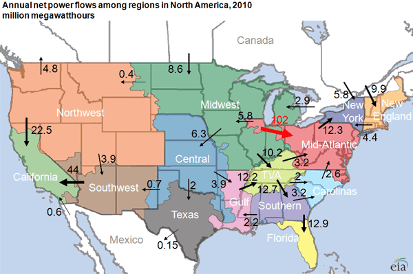

Regions of the US and Canada adjust their steam valves* to keep energy flowing between them and their neighbors where they want it.
*(water valves for Hydroelectric plants)
http://www.eia.gov/todayinenergy/detail.cfm?id=4270
The map above belowjh shows that electricity tends to flow south in North America. The numbers on the map reflect average net power flows—metered hourly—between electric systems aggregated by regions for the year 2010. Most electric power demand is served by local generators. Net interregional trade accounted for less than 1% of delivered power in 2010. However, excess, low-cost power—primarily from hydroelectric generators in the Pacific Northwest, Manitoba, and Quebec—supplied higher-cost markets to the south.
In the map above, the numbers next to the arrows represent annual net flows of electricity between regions measured in millions of megawatt-hours.
