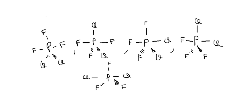

Summary:: Isomery
My attemption: (I found 5)
But the answer is 3 forms, where I missing?
For whatever reason, I think the issue is that the top right structure and the bottom structure are mesocompounds and the top 2 middle ones are mesocompounds as well, I could be very wrong but that's what I am thinking.

What makes you think 1 is different from 2, or 3 from 4?
Exactly, they are mesocompounds, but they also count as stereoisomers.
Yes you are right. I already found my mistake
