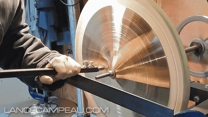

I don't have much knowledge of physics sadly, and I want to build a machine that can spin a disk.
My question is - How can I know the weight I can spin on a motor?
I need to be able to spin around 5-6kg, for 350 RPM, and I'm not sure I'm aiming for the correct motor.
I'm thinking of a 1HP, 1730 RPM motor, that I can slow down to get to the correct speed.
(https://www.ebay.com/itm/353221688661?hash=item523da73d55:g:ONQAAOSwK2Zfde67)
I've done some calculations, but I'm not sure I know exactly what equations I'm supposed to look at. Also, I don't know how to calculate the acceleration of a motor.
I would really appreciate the help, and I hope this is the correct place for me to ask these kind of questions.

It will be a round shape, I can show you a picture of what I imagine it should look like.
The wooden circle is supposed to be 23" diameter.
Like jack said, there is additional friction torque on my system, I'm not sure how to measure it though.
The acceleration is not important, I don't mind waiting before it gets to 350 RPM.Also, I'm planning on using pillow block bearings.
Assuming that you are trying to do some of the stuff shown at lancecampeau.com, here are some suggestions.
While a 1730 RPM motor can be slowed to 350 RPM using a variable frequency drive (VFD), you are far better off to reduce the speed using a speed reducer. A good speed reducer for your application is a V-belt drive with a 5:1 speed ratio. That will give you exactly the 350 RPM you want, plus it will multiply the torque by 5 times. Without the speed reducer, it might not have enough torque to meet your needs. You can still use a VFD to get additional speed control.
Using a 1/2" V-belt, a 2" pulley on the motor, and a 10" pulley on the driven shaft will get the ratio you want. A 1/2" V-belt normally requires a larger pulley than 2", but a 2" pulley will work well enough in this application. These size parts are readily available at low cost. A 3/8" V-belt would work even better on this small pulley.

Are you building a “metal spinning” lathe? If so, the power needed will be the force applied * friction coefficient * speed * radius of the work. For large flat items you will need lower RPM. For small items higher RPM. That suggests you will need cone pulleys for your 'V' belts so you can change the speed for different working radii.
https://en.wikipedia.org/wiki/Metal_spinning
ASSUMPTION: I'm assuming that the OP is doing the type of things shown at lancecampeau.com. The loads are light, the speed requirements modest, and the required precision is comparable to that needed for a wood lathe.
Pillow block bearings will handle modest thrust loads. I once built a wood lathe using pillow block bearings for the headstock. It worked very well.
The drive I suggested will be sufficient to spin 5-6 kg at 350 RPM and do the sort of light work shown at lancecampeau.com.
Yes, I intend to do the type of things shown at lancecampeau.com. for another demonstration -
So just to make sure - a 1730 rpm reduced to 350 using a V-belt drive, 1HP motor will be able to spin 5-6 kg of material, considering the diameter is 23"?
Baluncore - it will always be large flat items. the diameter of the wooden circle, which I'll put the metal on, will always be 23".
The metal on top will range from 14" - 22".
