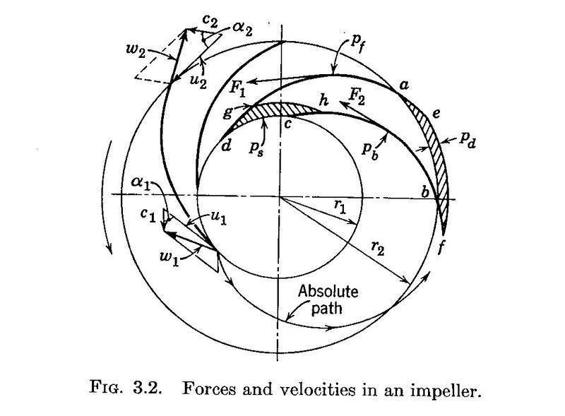

I thought that the pressure increase is only obtained in the diffuser part of the compressor as kinetic energy is converted to pressure, how compressor impeller also contributes to pressure increase?
The answer to your question is in the following figure from Chapter 3: Theory of the Centrifugal Pump Impeller in the book Centrifugal and Axial Flow Pumps by A.J. Stepanoff.
Please don't ask me to interpret it. I read the rest of the book and only skimmed the theory chapter. This figure is from a book about pumps, so is based on incompressible flow. Your question adds the additional factor of compressible flow. I expect that a better discussion would be in the following book by the same author, which I have not read: https://www.amazon.com/dp/B0007E6V9I/?tag=pfamazon01-20. Out of print, but should be in some engineering libraries.

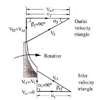

The impeller can also be a diffuser. Looking at the following velocity triangles, when you consider the relative velocities (i.e. ignoring the fact that the impeller rotates, just the flow through it) you can see that ##v_{r2}## can be set smaller than ##v_{r1}##, meaning that while traveling through the impeller, the air pressure rises.
Thank you so much. The concept is now clear to me.
