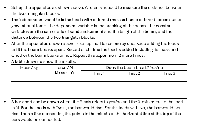

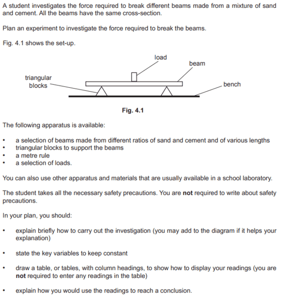

The question and my attempt at a solution are attached. Thanks.
The beams are of various lengths. You did not specify where the supports or loads are to be placed, and there is no mention of distances in your table.
I kept the beam length constant. Independent variable is the force and the dependent variable is whether the beam breaks or not. The rest are constant.

You cannot keep the beam length constant. You can keep the distance between the supports constant, but how to determine that distance, and where exactly should each beam be placed across them? And where should the load be placed?
A key aspect of experimental design specification is that others can repeat exactly what you did.
A trickier problem is what load to start with and by how much to increase it at each step. You cannot go back and try a slightly smaller load when it breaks. If you increase by large steps you will end up with a big margin of error; if you go in tiny steps it'll take a month.
Maybe that's beyond what is expected here, but can you think of an approach?

That distance is an arbitrary distance within the scope of the beam, where different masses would be placed on it until the beam breaks

Because the beams provided are of various lengths.
Not good enough. You need to say how you will choose the distance. If the beam lengths available are 2m, 3m and 12m, what distance would you choose?
Now, I did not set this question. Maybe you are not expected to address these points. I can only discuss how I would answer it.
