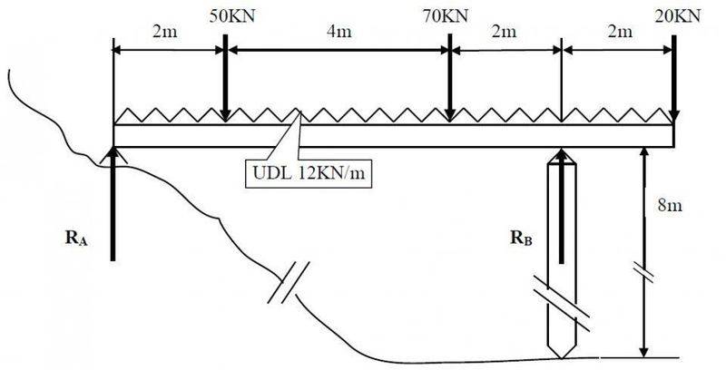

I am struggling with a part of the question. Please see diagram in the attached.
Calculate the relevant Elastic Modulus and select the lightest suitable beam section assuming a maximum allowable bending stress of 120 Mpa ?

10m being the total length of the beam in diagram and 140 KN being the total load I have worked out Ra and Rb if these are needed Ra = 95KN Rb = 165KN

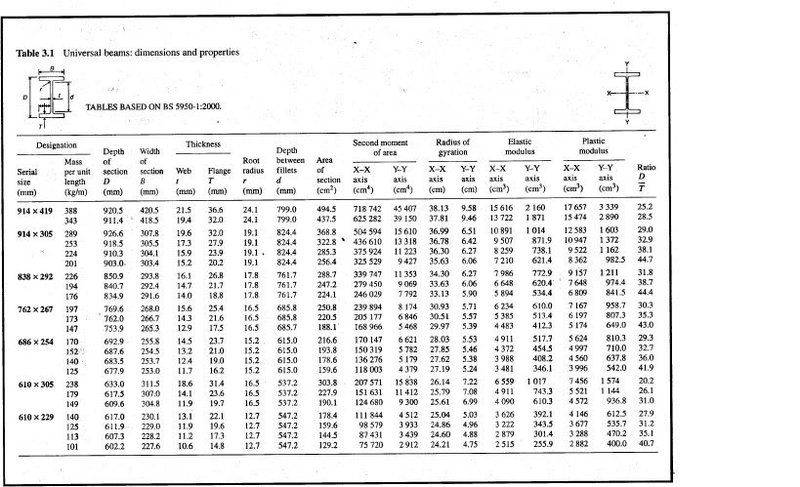

The full question is below for some reason it wouldn't allow me to upload the 2 files
Calculate the relevant elastic modulus and select the lightest suitable beam from the attached table 3.1 universal beams (based on Bs5950) assuming a maximum allowable bending stress of 120Mpa
What happened to the UDL of 12 kN/m?
{Edit: I see now. The load on the beam is not 140 kN. That's the sum of the concentrated loads. The load on the beam should be the sum of the concentrated loads and the UDL.}

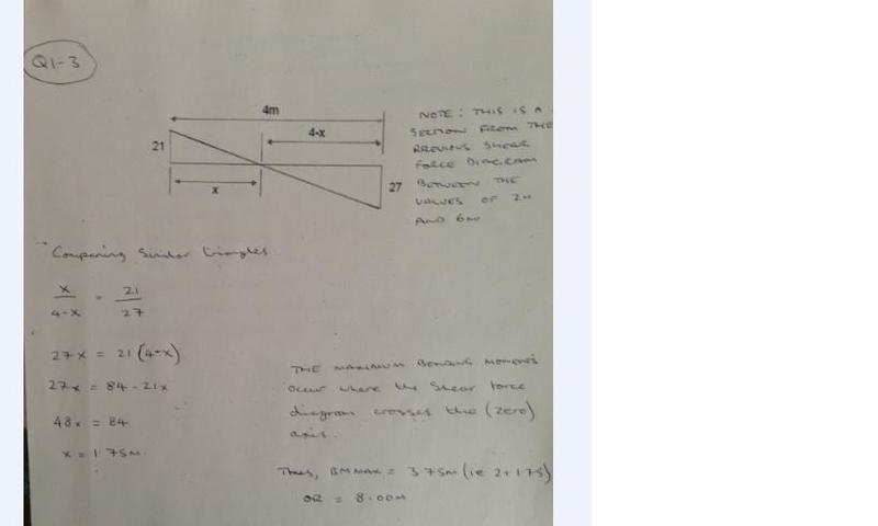

In the attached is the maximum bending moment measured at Ra

I have the shear force diagram in the attached I hope is correct? I have 4 parts left to answer for this question then the assignment is finished I am just struggling with these last few bits
If you have calculated the shear force diagram for this beam, then you should be able to calculate the bending moment diagram as well.

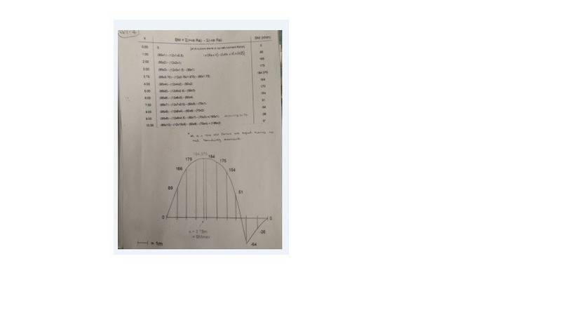

Bending moments in attached again not sure if I am correct !
The shear forces and the bending moments appear to be correct.
Now, use this information to solve the rest of the problem.
That's good then. That's the problem I am struggling on how to work out that question and 3 other parts ?

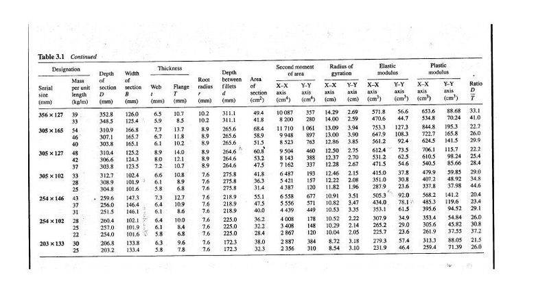

Morning SteamKing
I have looked at the tables which there are 3 of, the other 2 are in the attached. Obviously the Mass per unit is the total weight of the beam and not the max bending moment, which column covers what I am meant to be looking at please as there are no beams 10m long or have any max bending moments?
John54321 said:
Morning SteamKing
The tables are intended to compile design information about the different UB cross sections.
Beams of various lengths can be fabricated using such sections, which is why total lengths are not given. Some will be 5 m long, some will be 6-7/8 m long, etc.
The "mass/unit length" is just that: it tells you that a beam 1 m long fabricated from that particular section will have a mass of X kg. If your particular beam is 10 m long, then you'll obviously have to multiply the mass/unit length by 10 m in order to find the total mass of the beam. :wink:
As I mentioned previously, several times, knowing the maximum bending moment the beam must with withstand, coupled with the maximum allowable bending stress, will allow you to calculate the minimum value of the elastic section modulus, or I / y. These tables shorten this name to just elastic modulus, and you'll notice that two values are given: one for bending about the X-X axis, and another for bending about the Y-Y axis. Refer to the sketch on the first page of the tables to see which axis is which.
Remember: allowable bending stress, σ ≥ (max. bending moment) / (elastic modulus)
Here, σ = 120 MPa, and you have already calculated the max. bending moment as shown in Post #11 above.
All that's left to calculate is the minimum elastic modulus of the beam.
In this situation, we want to use the larger elastic modulus of the beam from the tables to compare with the value of the minimum elastic modulus calculated above, so that we can have a beam with the least mass while ensuring that the bending stresses are less than allowable.
Pay particular attention to the units of the elastic modulus, cm3. You want to make sure that the calculation of the minimum elastic modulus for the maximum bending moment in this particular beam has the same units.
