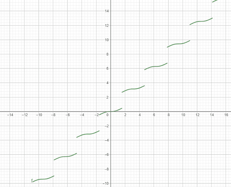

My task is to find all primitive functions to ##f(x)= \frac{\sin^2 x}{1+\sin^2 x}## on maximal intervals.
For intervals ##\left(-\frac{\pi}{2}+k\pi, \frac{\pi}{2}+k\pi \right)## it is quite easy: ##F(x)=x-\frac{1}{\sqrt 2} \arctan{\left(\sqrt 2 \tan x\right)}+C_k##. (##C_k## corresponds to a particular ##k##)
Since ##f(x)## is continuous in ##\mathbb R##, it has a primitive function in ##\mathbb R## as well, so we have to define ##F(x)## also for points ## \frac{\pi}{2}+k\pi##.
##\lim_{x \to \left(\frac{\pi}{2}+k\pi \right)^-} F(x) =\frac{\pi}{2}+k\pi -\frac{\pi}{2\sqrt 2}+C_k ##
##\lim_{x \to \left(\frac{\pi}{2}+k\pi \right)^+} F(x) =\frac{\pi}{2}+k\pi +\frac{\pi}{2\sqrt 2}+C_{k+1}##
And since it is continuous, we can write that ##C_{k+1}= -\frac{\pi}{\sqrt 2}+C_k##. But now I don't know how to continue. Am I close to the solution? How to write the whole definition for ##F(x)##?

As ##x \to \frac \pi 2##, we have ##\arctan(\sqrt 2 \tan x) \to \frac \pi 2##. So, we can define ##F(\frac \pi 2) = \frac \pi 2 - \frac \pi {2\sqrt 2}## and we have a continous primitive function.
So, could we write the solution in this form?
For ##\left(-\frac{\pi}{2}+k\pi, \frac{\pi}{2}+k\pi\right)##: ##F(x) = x-\frac{1}{\sqrt 2} \arctan{\left(\sqrt 2 \tan x\right)}+C_k-k \frac{\pi}{\sqrt 2}##
For ##\frac{\pi}{2}+k\pi##: ##F(x) = \frac{\pi}{2}+k\pi-\frac{1}{\sqrt 2}\frac{\pi}{2}+C_k - k \frac{\pi}{\sqrt 2}##
We subtract ##k \frac{\pi}{\sqrt 2}## because when we go from one interval with ##k## to another one with ##k+1## (when considering the unmodified function), the value at point ##\frac{\pi}{2}+k\pi## is greater by ##k \frac{\pi}{\sqrt 2}##, so if we want the function to be continuous, we always have to shift it on given interval by ## k \frac{\pi}{\sqrt 2}## downwards.
I imagine it this way because the graph of the unmodified function looks like this
For a continuous function with period T (such as \sin^2 x/(1 + \sin^2 x)), its antiderivative on [0, \infty) can be written as \begin{split}<br /> F(t) &amp;= \int_0^t f(s)\,ds + C \\<br /> &amp;= \sum_{n=0}^{\lfloor t/T \rfloor - 1} \int_{nT}^{(n+1)T} f(s)\,ds + \int_{\lfloor t/T \rfloor T}^t f(s)\,ds + C \\<br /> &amp;= \left\lfloor \frac{t}{T} \right\rfloor \int_0^T f(s)\,ds +\int_0^{t - \lfloor t/T \rfloor T}f(s)\,ds + C \end{split} so that the only integral you actually need to calculate is \int_0^t f(s)\,ds for t \in [0,T]. This can be extended to negative t, but one must be mindful of how \lfloor \cdot \rfloor works for negative numbers.
