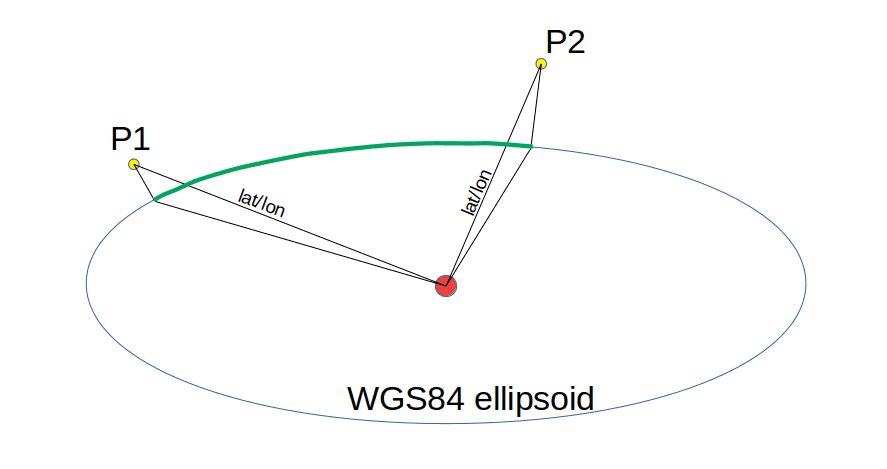

This seems like a trivial question at first, but I am struggling how to get it right. If I have 2 GPS (lat, lon, height) observations P1 and P2 taken at some height from the Earth's surface, how do I calculate the straight line distance between them? I am using the picture below to illustrate the question and get into more detail.
I understand GPS devices provide heights in reference to the WGS84 ellipsoid and perpendicular to the ellipsoid's surface (lines labelled "gps h"). I also understand latitude and longitude are angles originating at the WGS84 ellipsoid centre.
Are my assumptions ok? Can anyone out there can explain how to calculate the distance between P1 and P2?

Possibly you are misleading yourself by the gross over-simplification of your diagram which just shows an ellipse and pretends that it is an ellipsoid in a way that doesn't really reflect what is happening.
I know my diagram is simple, but the question still valid, no? Would you be able to help?

@aydos -- shouldn't the "heights" in your diagram be in the same plane as the ellipsoid that you've drawn? If planes climb to altitude above the surface of the Earth, they don't move parallel to the ground, which is what your drawing seems to show.

First you must convert the Latitude, longitude and height to an Earth centred x, y, z.
Do that for the two points using the following code to get x1, y1, z1 and x2, y2 and z2.
Take the differences to get dx = x2 - x1, dy = y2 - y1 and dz = z2 - z1.
Sum the squares of the differences, then square root to get your straight line distance.
This is the WGS84 code to convert GPS lat, lng and height, to x, y, z.
Note: that the Latitude and Longitude may need to be in radians. With the heights in metres. Radians = degrees * Pi / 180.

Hi @Baluncore , thanks so much for your reply. That is exactly what I was looking for. One doubt remains for me. Its about the (RofC + h) term at line 10.
The actual height reported by the GPS is not parallel to the ellipsoid radius, rather perpendicular to the ellipsoid surface. Am I correct to assume that the blue term above does not take that into account?
Your application is based on GPS from a moving vehicle, so the algorithm does not need to be particularly accurate. I believe that for an aircraft covering only a few kilometre, you could find the distance traveled to better than 100 mm by assuming a spherical Earth with a fixed radius.
The source of my code is lost in a 30 year old paper filing system. I believe that it is better than 1 mm when using double precision. The radius of the Earth is large compared with the height of an aircraft so it should make less than 1 mm difference either way. Since you are subtracting two nearby conversions, any approximation error should largely cancel.
