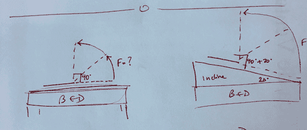

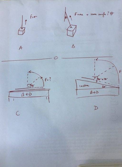

Ok here are my drawings. 4 scenarios.
A: Simplistic F = ma of lifting an object up from the ground.
B: Force at an Angle = Not sure how but if the same object was being lifted up, but at an angle, the force would be different? Like in those examples of a horse pulling a cart vs the same horse pulling that same cart but from a sideroad, at an angle. I kinda remember we needed to consider the angle somehow.
What I really want to understand is the getting out of bed example.
C: Getting up out of bed requires you to lift a weight from 0 angle to 90 degrees (sitting up). This requires a certain force.
D: I want to udnerstand the basic C scenario in order to understand how that would change when inclining the bed, so the person needs to sit up, once again to 90 degrees from the bed, but this time the bed is inclined 20 degrees.
Actually it involves rotating a mass from the horizontal to the vertical position so it requires a torque rather than a force. The torque is at a maximum when the trunk is horizontal (just starting to rotate off the bed.)

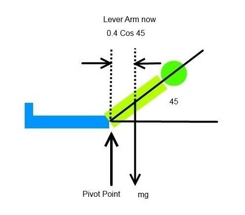

Ok so this shows how to calculate the max torque.
Torque = force * length of lever arm.
As you sit up the length of the lever arm reduces until the centre of mass is over the pivot point. The length of the lever arm and the torque is at a maximum when you are horizontal as shown.

B/ If I wanted to consider the changing length of the lever arm as I sit up, I would need to use calculus?
Basic trig might be all you need. For example if you lift up to the 45 degree position the lever arm is 0.4 Cos 45 = 0.28 and the torque falls to 83 * 9.8 * 0.28 = 227 Nm.

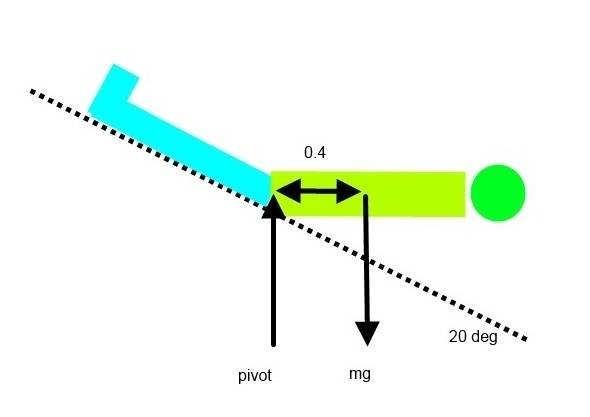

Ok I didnt understand either of your answers. I am slow. :-)
A/ I didnt mean raise just the legs. I meant that the entire bed, instead of being flat (0 degrees), the bed is now inclined 20 degrees. Its like making situps in a gym, where you have those boards that you can incline to make the situp workout harder.
How does that factor in? I thought it just meant the torque angle was greater by 20 degrees?
Yes I understood that.
The peak torque required is still the same and it still occurs when the trunk is horizontal (see new diagram).
I agree it is harder to do sit ups that way. That's because now you start with your head lower and have to do work just to get to the horizontal position.
