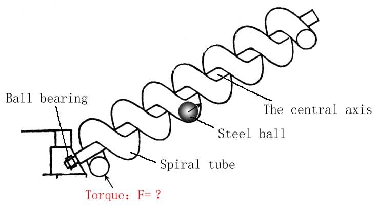

How to calculate this torque? (steel ball in a spiral tube)
In summary, the parameters can be assumed by themselves. The spiral tube is fixed on the central shaft, the central shaft is mounted in the ball bearing, and the thrust F acts perpendicularly on the surface of the spiral tube. Conservation of energy might be useful to consider to find the torque induced by the steel ball.
vxiaoyu18
93
TL;DR Summary
Spiral tube torque calculation.
Want to let the steel ball move upwards at a uniform speed, how is the torque of the spiral tube calculated?
The parameters can be assumed by themselves.
**The spiral tube is fixed on the central shaft, the central shaft is mounted in the ball bearing, and the thrust F acts perpendicularly on the surface of the spiral tube.
**Parameters that may be needed: pi = π, Earth gravity coefficient = g, steel density = ρ, steel ball radius = r, bearing friction coefficient = u, steel central axis mass = M1, steel ball mass = M2, steel spiral tube mass = M3, spiral tube inclination = 45, steel spiral tube parameters: inner diameter = d, outer diameter = D, wall thickness = s, pitch = L, number of turns = n, height =H, helix diameter = D1, rotation outer diameter = D2, helix length = C.

If there is no steel ball, then: F=(M1+M3)*(D2/2)*u
Is this a homework question? What did you figure out so far?

This is a part of my machine, I can make that machine, but I don't know the calculation here.
Is there no support of the shaft at the top end? (e.g. another bearing?)
Is the lower bearing the only support for the total assembly?
To reduce friction, only one linear bearing is used. When the spiral tube is not big, it can be fully supported.
I think that the steel ball stays at the lowest point of the spiral circle and may not produce the force that causes the rotating spiral tube.
Your diagram arrow on the ball is upward, indicating you are trying to lift the ball from the bottom to the top of the spiral; but, your above post implies you want the ball to rotate the shaft by traveling down the spiral. Which one of those scenarios is the one you are trying to accomplish?
For either case, you need to reduce its vertical downward weight into two resulting force components, one parallel to the shaft center line and the other perpendicular to the shaft centerline. The force parallel to the shaft centerline is the amount of force the ball will exert to either: rotate the shaft; or, resist the rotating of the shaft, if you are trying to lift the ball.
Either way, the torque from the ball = M2 x g x sin(L/D) x sin(45°) x (D2 - s - r)

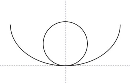

That diagram can only be exact if you have a circular tube around the shaft, for a helix it won't work, your system is inherently three-dimensional.
Consider an idealized case where there is no friction and the whole system is free to rotate: The gravitational force on the ball will certainly make the helix rotate such that the ball moves down. There must be a torque from the ball.

My goal is to calculate the torque that the spiral tube will allow the ball to rise at a constant rate.
Many thanks to JBA for your answers.
As you explained:
F=(M1+M2+ M3)*(D2 / 2)* u+M2*g*sin(L / D)* sin(45°)*(D2 / 2 - s - r)

Just as a note: Since you are turning this with some device to drive the helix and lift the ball, the inertia of M1 & M3 only affect the Torque on startup and not during continuous operation. Once the spiral assembly is rotating they will have no affect on the required operating torque of the unit other than any friction their cantilevered load might cause in the supporting bearing.
In that respect, you do not show any driving motor in your diagram so how do you intend to rotate the assembly?
JBA said:
Just as a note: Since you are turning this ……
I will use an external force to make the spiral tube rotate at a constant speed to raise the steel ball. I still don't understand what "sin(L / D)* sin(45°)" means in your calculation formula. The horizontal angle of the helix should be: arctan (pitch/circumference of spiral diameter) =arctan(nL/πD2) ) .
That is: F =(M1 + M2 + M3) * g*(D2 / 2)* u + M2 * g *sin(arctan(nL / πD2))* sin(45°)*(D2 / 2 - s - r)?
One turn of the helix will lift the ball, h = L * Sin(45°)
Knowing the mass of the ball, m, the energy required for one turn can be calculated.
PE = m·g·h;
Power = rate of energy flow = PE / turn / second.
Torque = power / angular velocity.

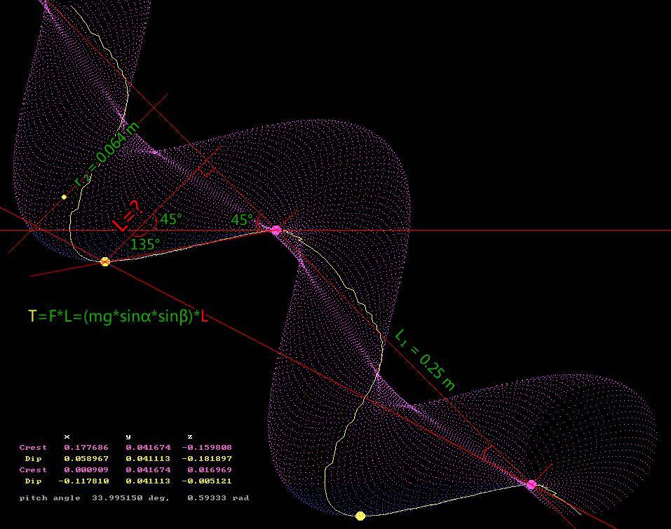

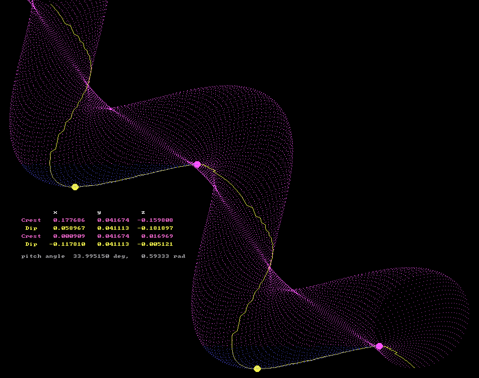

I believe I can now identify the position of the dip that a ball will rest in.
I need numbers for these four parameters;
1. Pitch of the helix; = axial advance per turn.
2. The angle of the helix rotational axis, measured from the vertical.
3. Radius of the helix, that the central axis of the tube follows.
4. The internal radius of the tube.
To me it seems there are only 3 important numbers in this problem to 1st approximation,
vertical distance the ball will drop, distance the ball is from the central axis of the spiral, angular rotation angle of the spiral tube.
Can we equate torque times angular rotation of the spiral tube with energy the ball loses when it drops some distance d, mgd?

If the tilted helix of tube is held so it will not rotate, then the ball will rest at a minimum on the tube inside surface. In that static situation there is a torque generated by the mass of the ball offset from the helix axis. Without movement there can be no energy expended.
Where in a turn of the tube will the ball rest? and what will that static torque be?

Let me just reimagine the problem for the sake of math.

The length of the helix is irrelevant to the torque. One turn is sufficient.
The simple spherical ball has a mass m, and fits freely inside the tube.
The ball rolls on the inside surface of the tube. That contact is one tube radius from the tube axis.
The tube axis follows a helical path about the helix axis.
A “helix” is like the thread on a bolt or cylinder. It has a pitch independent of radius.
Mathematically, a “spiral” is a line drawn about a point on a plane. It has a changing radius.
Please don't use the informal term "spiral" when referring to a "helix". Not only are there helical tube pumps, but there are also spiral tube pumps. It is important to avoid confusion.
