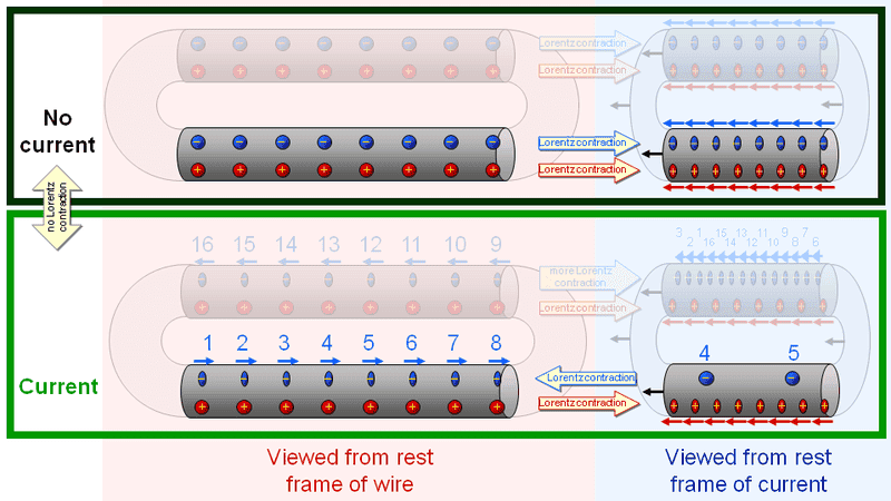

In summary, the animation is incorrect and does not accurately represent how superconductivity works.
Geocentricist
55
Superconducting Ring
In a superconducting ring does the contraction of space between electrons cause them to move inwards? Like in this animation.
Force Between Parallel Wires With Current
In the proton frame of two parallel wires with identical current, I've been told they attract and this is because the motion and length-contraction of the electrons increases the negative charge density. Is this correct? Because it seems this explanation accounts for the protons in one wire being attracted to the excess electrons in the other wire, but ignores the excess electrons being repulsed by the excess electrons in the other wire.
This animation shows a neutral wire becomes negatively charged when a current runs through it. So it's easy to see how two such wires would repel each other.
Veritasium's Video On Electromagnetism
I'm referring to this video:
Notice the separation in the electrons' rest frame at 1:17. Twelve electrons fit on the screen.
At 1:28 the electrons start moving but their separation remains the same.
At 2:08 the electrons' rest frame is again shown but the separation has increased so only 8 of them fit on the screen, and no explanation is provided for why this is.
Did Veritasium make a mistake with this video?
Another thing is at 1:28 when the electrons start moving, it seems their density should increase, and attract the cat-ion. Yet this density increase is not shown. In fact the narrator specifically says the density doesn't change.
No, there is essentially nothing correct about that animation. In superconductivity electrons are no longer spatially localized.

Okay. But what about the video showing electron spacing change while the electrons are at rest? Is that correct?
A.T. said:
Even though the fields of the electrons are contracted, they are still repelling each other, so they still spread as far apart as possible within the same wire length.
Wouldn't "as far apart as possible" be contracted?
Would you happen to have a similar graphic explaining the force between two parallel, current-carrying wires?
If the blue spheres represent electron probability clouds instead of actual electrons, would the animation be correct?
No, the animation is flat out wrong. The electrons are not localized, that means that their probability cloud is spread out throughout the entire superconductor. They don’t have a location, they don’t move around the wire, they don’t contract, and they certainly don’t jump off the inside of the superconductor! The animation is about as wrong as it can possibly get
Ok, thanks.

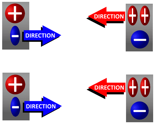

Okay, so if I consider the lab frame and simplify each wire to just one proton and one right-moving electron each, I can see how the magnetic force causes the two wires to attract. Both electrons move to the right, so they attract each other with a magnetic attraction greater than their electric repulsion, and I just ignore the protons since they aren't moving.
But what about in the electron frame, if I consider each wire to be two protons moving left and one stationary electron? Does a pair of left-moving protons attract to another pair of left-moving protons with an attraction strong enough to overcome their electrostatic repulsion? Would this mean magnetic force is stronger than electric force?
No, the net force is always repulsive for a pair of protons.

So a pair of electrons moving together attract but a pair of protons moving together doesn't?
Then I'm back to having two left-moving protons and an electron, and another two left-moving protons and an electron. Since each of these two clusters are net positive, and therefore an electric force repels them, how do I explain why they actually attract?
I didn't comment on your answer to my second question because I don't understand it.
For both a pair of electrons and a pair of protons the electric force is repulsive and the magnetic force is attractive and the net force is repulsive (the quantity is positive).
Through the magnetic fields! In this case the magnetic force is stronger than the electric force (the quantity is negative). Yes, there is a net charge on the wire, but it is small compared to the current.

But I thought you said earlier a pair of moving electrons attract? Now you say they're repulsive? How am I going to explain why the wires on the left attract then?
I'm so confused because now it seems you're contradicting what you just said, that a pair of a pair of protons repulse (the net force is repulsive because the quantity is positive).
To simplify, the question was if the electric field was stronger or the magnetic field. The answer is: it depends. In the case of two comoving charges the electric field is stronger. In the case of two parallel currents the magnetic field is stronger.
Okay so two comoving electrons, their electric force (repulsion) wins. So I'm at a loss as to how the wires attract in the lefthand scene, and I had thought I got that part down.
Two isolated electrons will always repel. Two isolated protons will always repel. But you can't treat a wire as isolated protons and isolated electrons because that would be ignoring the interaction between the electrons and the protons.
If you analyse a pair of parallel current carrying wires in their rest frame then you will see only a magnetic field which causes an attractive force. If you view them in any other frame you will see a (different strength) magnetic field which causes an attractive force, but also an electric field which causes a repulsive force. The attractive magnetic force will always be stronger than the repulsive electric force so the net force will always be attractive.
You can analyse this in terms of pairs of streams of positive and negative charges with different velocities and rest charge densities, but you must remember both the electric and magnetic effect on one stream due to all three of the others. Sometimes you can short cut it and note that some effect cancels with another one - for example in the rest frame of the wire the electric effect of a proton stream cancels the electric effect of its electron stream. But that does not hold in every frame.
Likes Geocentricist and 1977ub
No, I said that the magnetic force between a pair of electrons is attractive. The electrostatic force is repulsive. In this case the electrostatic force dominates and the net force is repulsive.
Through the magnetic force. In this case the magnetic force dominates and the net force is attractive.
Well there a is really simple thing that you are ignoring:
The positive thing at the top left corner of the picture attracts the negative thing at the bottom left corner of the picture.
Likes Geocentricist and Dale
Okay, thanks for all the responses. I've figured out that in the first situation, all forces cancel except for the magnetic attraction between the two moving electrons. But in the second situation, I'm still working on it. The two protons in each wire repel each other electrostatically, but also attract magnetically, right? But since electrostatic force is stronger than magnetic, this would mean there's a net repulsion yet this is not true so I must be wrong somewhere.

  • #31
Well now the two positive thighs at the top right corner of the picture attract the one negative thing at the bottom right corner of the picture. Just normal electrostatic attraction. Oh yes, the two positive things would be farther apart if they we not moving.If we make the positive things move together very fast, we can ignore net force between them, because the net force becomes very small. If the fast motion causes more positive things to get into the picture ... then it isn't so simple.

Ibix said:
In what setup, in what frame, between what objects?
In the frame of two wires with moving electrons, if a moving electron repels another moving electron with an electrostatic force of 1 then how strong is the magnetic attraction between them?
Okay, but doesn't the top proton pair repel the bottom proton pair with double the force that it attracts the bottom electron? So the top wire is still, overall, repelling the bottom wire, contrary to the result I'm aiming for (the reality that the two wires attract).
Also I wanted to bump one of the original questions I had in the OP about Veritasium's video, which is, are they mistaken in portraying the electron-frame electron spacing different at different times?
No. There's the 'magnetism' thing. Parallel currents attract.
But now that I thought about it I noticed that the contraction thing and the 'magnetism' thing cancel out in the electron frame. No matter how fast the protons move the net force between them is the always the same - which means it's the same as when the speed is zero. This is in the electron frame.
  • #34
I know that if I put two wires with identical current side-by-side they will attract. But I want to know why this is by understanding the electrostatic and magnetic forces between the protons and electrons. That's why I'm confused as to how they can attract given they are both net positive (they each have 2 protons per electron). So there must be some magnetic force that overcomes this repulsion. Since the electrons aren't moving, they can have nothing to do with this magnetic force as it only involves moving charges. So does the magnetic attraction between two co-moving pairs of protons overcome their mutual electrostatic repulsion?
I'm confused. When the protons don't move there's only one proton in the wire as opposed to two. So how could the net force between them be the same?
  • #35
No motion - no contraction.
No motion - no 'magnetism'.
