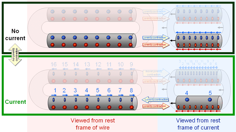

  • #118
Geocentricist said:
So if I drop two identical rocks from the same height at the same time, the rocks will disagree on who hit the ground first?
What does this have to do with electromagnetism? If that is still your goal then the answer to this question won’t help and asking it just encourages the thread to get further from your goal.
  • #119
Totally different case because the separation between the rocks is perpendicular to their acceleration rather than parallel. If you are not familiar with how fundamental this difference is in SR, then you really need to read any standard introduction to the subject, because we cannot teach you SR from the ground up.
  • #120
I've put off the electromagnetism thing for a bit until I understand why the electron spacing increases in their own frame. Also because I spent a lot of time with those graphics only to find they were wrong.
The thing about the rocks falling was supposed to be analogous to the electrons accelerating, but I think I messed that up. So I will rephrase it. If A and B are both stationary and both experience the same gravitational force (for example, a couple rocks sitting on the ground), will they disagree on what events are simultaneous?
  • #121
No, because they are not accelerating relative to their starting position.
What is true is that if clocks spaced in the x direction start accelerating in the +x direction, then if they if they are to agree that their mutual distance doesn’t change, then the one further in the +x direction has to have less proper acceleration (and, in the original rest frame, they will get ever closer together). If, instead, they have the same proper acceleration, then they will both agree the distance between them is growing ( and in the original rest frame their distance will be constant).
Proper acceleration is what is measured by an accelerometer.

  • #144

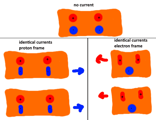

How's this? Is this correct? Obviously didn't put as much effort as I did in the other ones.
  • #145

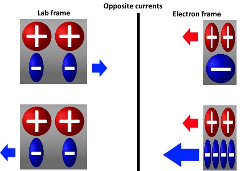

Geocentricist said:
Is this correct?
DrGreg's diagram is better because it shows at least two electrons in each case, so you see their spacing:
For two identical currents duplicate the lower part of the loop.
For two opposite currents look at the lower and the upper part of the loop.
  • #146
DrGreg's diagram is not suited for my purposes since there are too many particles and also, not a simple ratio of electrons to protons in each frame. Is mine correct?
  • #147
Geocentricist said:
DrGreg's diagram is not suited for my purposes since there are too many particles ...
Just enough to have at least two electrons in each case, so you see their spacing. The perfect amount.
Geocentricist said:
...and also, not a simple ratio of electrons to protons in each frame.
What is a simple ratio? What non simple ratios do you see in DrGregs diagram?
Geocentricist said:
Is mine correct?
It doesn't show enough particles to tell.
  • #148
A.T. said:
Just enough to have at least two electrons in each case, so you see their spacing. The perfect amount.What is a simple ratio? What non simple ratios do you see in DrGregs diagram?
In one frame the ratio is 0.25 which is harder to work with than mine which is 0.5. Not a big difference but I want to keep things simple as possible!
Sure it does, the ratio is all that matters and you must assume the segment I've shown is representative of the ratio of the entire wire
  • #149
The ratios are 1:1, 1:2 and 1:4. Doesn't get simpler than that, if you want to show all cases (3 ratios).
Likes Geocentricist
  • #150
Ah you're right.
