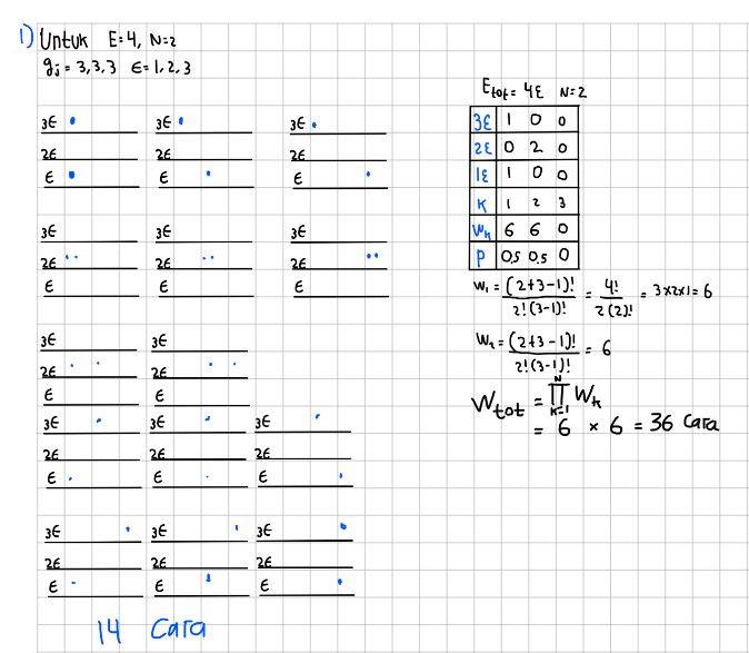

This is very basic question but to be honest I dont understand even though I read Pointon's book. The question said what is all possible ways to arrange Bosons and how much is the total configuration. The energy states/levels are = 1E, 2E, and 3E. The total of boson particles are 2, and all of the states should have degeneracy/g_j = 3 and total Energy E = 4.
Is my answer incorrect? Thank you
W = \frac{(n+g-1)!}{n!(g-1)!}
In your enumeration of states, you are missing one case.
Your calculation on the right is correct only for distinguishable particles. This should not apply to identical bosons.
