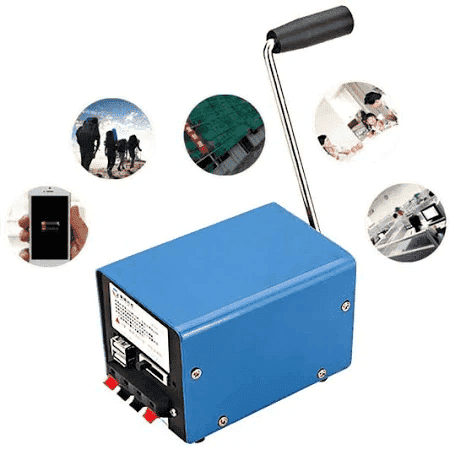

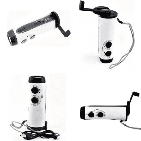

Buy some of the units in the link below and take apart and learn how others solved your rather complex problem? Discover the weaknesses of others designs and then design something better. Very hard without the proper skills, materials, and tools. Good luck.
https://www.google.com/search?tbm=s......1ac.1.34.products-cc..1.20.495.pYkD8NENZfI

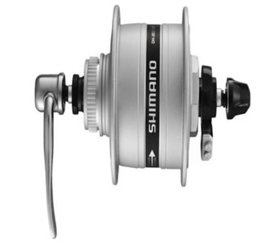

And some generators from the bicycle world. The links are the first of each type that I found. There are other manufacturers and other suppliers for both styles.
The good old friction wheel against the tire: https://www.amazon.com/dp/B00H3RDVKO/?tag=pfamazon01-20
And the hub generator: https://www.nashbar.com/shimano-dh3...MI57-m54Wf4wIVQrjACh24WguwEAQYAyABEgIHifD_BwE
These generators are typically available in either 6 or 12 volts. The specification list the power, from that you calculate the current. They typically deliver full power at about 10 to 12 MPH, from that you calculate the RPM needed.
