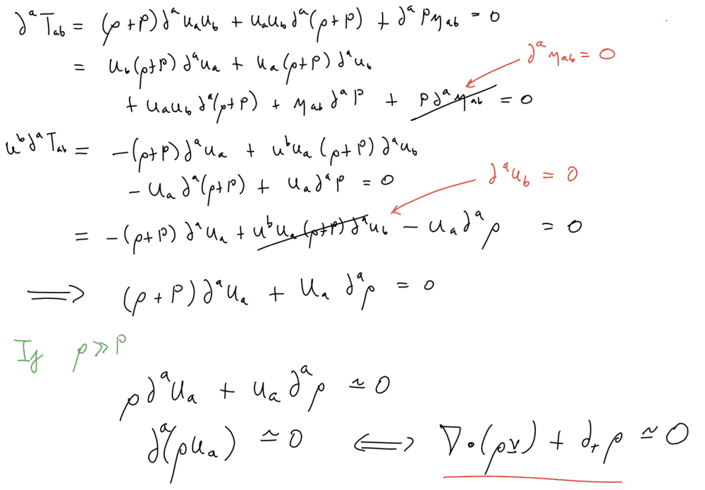

Stress tensor for the fluid is ##T_{ab} = \rho u_a u_b + P(\eta_{ab} + u_a u_b)##, whilst the equation of motion (assuming the system is isolated) is given by ##\partial^a T_{ab} = 0##. So I tried$$\begin{align*}
\partial^a T_{ab} &= \partial^a \rho u_a u_b + \partial^a P(\eta_{ab} + u_a u_b) \\ \\
&= \left[\rho \partial^a u_a u_b + u_a u_b \partial^a \rho \right] + \left[ P \partial^a u_a u_b + u_a u_b \partial^a P\right] + \partial^a P \eta_{ab} \\ \\
&= (\rho + P) \partial^a u_a u_b + u_a u_b \partial^a (\rho + P) + \partial^a P \eta_{ab} = 0
\end{align*}$$I would like to arrive at the result that if ##(u^{\mu}) = (1, \vec{u})## and ##\vec{j} = \rho \vec{u}##, then in the classical limit we recover ##\partial_t \rho + \nabla \cdot \vec{j} = 0##. How can I proceed, and juggle the indices, to do this? As always, your help is much appreciated ☺

Thanks for the comments! @Ibix I saw your reply a little too late after I'd already worked something through, but looking now I can see how doing so strongly suggests the required approximation.
PeterDonis said:
You're not applying the product rule correctly. For example, ##\partial^a \rho u_a u_b## expands into three terms, not two.
I believe what I wrote is correct, I just chose to write it as two terms instead of three. But I think you're right that it's easier to expand everything out.
[Here it was used that ##\partial^a \eta_{ab} = 0## and ##\partial^a u_b = 0##]$$\begin{align*}
\partial^a T_{ab} &= (\rho + P) \partial^a (u_a u_b) + u_a u_b \partial^a (\rho + P) + \partial^a P \eta_{ab} = 0 \\ \\
&= u_b (\rho + P) \partial^a u_a + u_a (\rho + P) \partial^a u_b + u_a u_b \partial^a (\rho + P) + \eta_{ab} \partial^a P + P \partial^a \eta_{ab} \\ \\
u^b \partial^a T_{ab} &= -(\rho + P) \partial^a u_a + u^b u_a (\rho + P) \partial^a u_b - u_a \partial^a (\rho + P) + u_a \partial^a P = 0 \\ \\
&= -(\rho + P) \partial^a u_a - u_a \partial^a \rho = 0
\end{align*}$$This means that$$(\rho + P)\partial^a u_a + u_a \partial^a \rho = 0$$If ##\rho \gg P##,$$\rho \partial^a u_a + u_a \partial^a \rho \approx 0 \iff \partial^a (\rho u_a) \approx 0$$Or alternatively$$\nabla \cdot (\rho \mathbf{v}) + \partial_t \rho \approx 0$$I needed to use that ##\partial^a u_b = 0##. I believe this follows from ##\partial^a x_b = {\delta^a}_b \implies \partial^a u_b = \partial^a \left( dx_b / d\tau \right) = d/d\tau \left( \partial^a x_b \right) = \frac{d}{d\tau} {\delta^a}_b = 0##, is that right?
It's not, in general, so that doesn't work.
No, since ##\partial^a x_b = {\delta^a}_b## is not correct.
Likes vanhees71 and etotheipi
etotheipi said:
I'll just attach my notes because I'm a little too sleepy to try and write everything up in LaTeX.
The correct response to this is to wait until you have the energy to type it in LaTeX. We can't quote individual equations from your images; that's a big reason why we do not permit equations in images.
Yes, I see now that by ##\partial^a u_a u_b## you actually meant ##u_b \partial^a u_a + u_a \partial^a u_b##, which is correct. However, writing it as just a single term is highly ambiguous; normally derivative operators only operate on what is immediately to their right, not on everything to their right, unless you use parentheses; so writing it as a single term would have to be ##\partial^a \left( u_a u_b \right)## to be unambiguously correct.
Interesting! Would it instead be $$\partial^a x_b = \frac{\partial x_{b}}{\partial x^{a}} = \eta_{bc} \frac{\partial x^c}{\partial x^a} = \eta_{bc} \delta_{ca}$$But the RHS still looks constant, so why would$$\frac{d}{d\tau} \partial^a x_b = \frac{d}{d \tau} \left( \eta_{bc} \delta_{ca}\right) = 0$$be incorrect? Also, is the part about ##\partial^a \eta_{ab} = 0## fine, or is that off too?
[Also, I'll start writing up the LaTeX]
etotheipi said:
Would it instead be...
No. I suggest taking a step back and thinking about what, physically, the expression you started with means. As John Wheeler said, you should never attempt a physics calculation unless you already know the answer. :wink:
What does ##\partial^a u_b## mean? It means the rate of change of the ##b## component of the 4-velocity of the fluid, along a curve where all of the coordinates except ##x^a## are constant. There is no reason, physically, to expect that to always vanish. So you should immediately be suspicious of any math you think you have found that seems to be telling you it does always vanish.
Taking another step back, you should not need to use ##\partial^a u_b = 0## in order to figure out how to get the continuity equation (and the other equation I referred to) from ##\partial^a T_{ab} = 0##.

PeterDonis said:
Note that, for this split to work, you also have to make an assumption about the relative magnitudes of the time and space derivatives of the pressure ##P##, in addition to the ##\rho >> P## assumption I already mentioned.
Actually, I misstated this. The only additional thing you need about ##P## to get the continuity equation from the ##b = t## component is that ##\partial_t P << \partial_t \rho##, and that follows from ##P << \rho##.
Likes etotheipi
PeterDonis said:
You should expect to find one 4-tensor equation with a free index (##b##) on both sides, which therefore translates into four component equations; the ##b = 0## (or ##b = t##) component equation gives you the continuity equation, and the ##b = i## (i.e., spatial) component equations, taken together, give you another equation which is a key equation in hydrodynamics.
One other thing you will need in order to do the split referred to here is translations of expressions like the operator ##u_a \partial^a## and the scalar ##\partial^a u_a## into "3 + 1" notation. I'll do the simpler of the two here:
\partial^a u_a = \partial^t u_t + \nabla \cdot \vec{u} = \nabla \cdot \vec{u}
where the second equality holds because, in the approximation you are using, ##\partial^t u_t = 0## (since ##u_t## is constant).
Likes etotheipi
