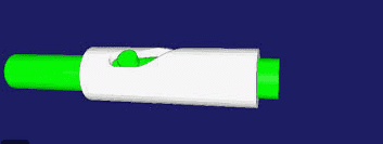

In summary, The angle of the helical track on the barrel sets the torque ratio. The follower (green part) moves up and down and rotate , the white part is fixed. The movement is from B to A in vertical positionAxial movement of the green shaft inside the fixed barrel causes the green shaft to rotate.

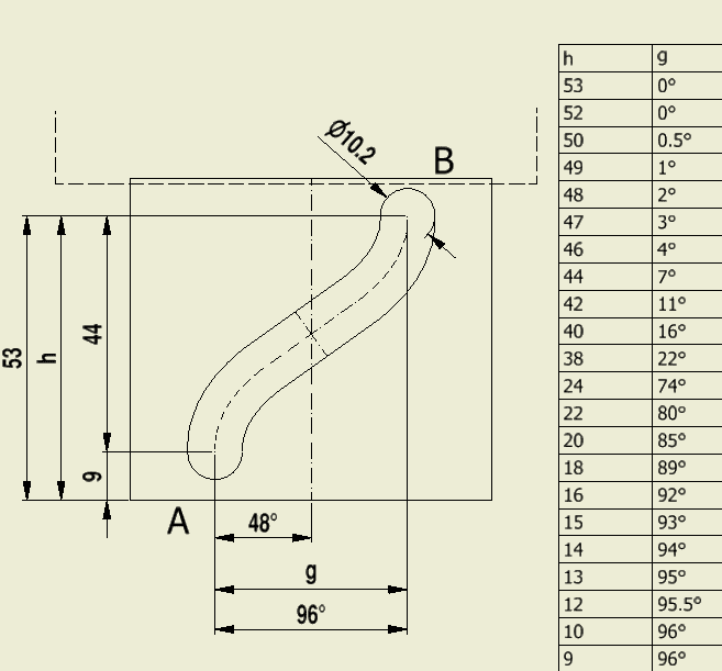

here is the sketch
the cam and follower are similar to this
If the input is h, and the output is g, then it has high initial torque now, because the ends of the track are curved to move the follower more slowly.
Slow follower movement can provide high torque, fast follower gives low torque.
For linear axial movement, the rotation is initially slow, so it has high initial torque.
So I need to eliminate the initial and final straight path line and decrease the initial angle to become more flat ?
That depends on what you mean by "improve torque".
The relationship between axial force, and the rotational torque, is the tangent of the track angle on the surface of the cylinder. Change the direction of the track on the barrel, to change the ratio of those forces.
What I need Is the maximum torque value at the beginning and at the end of the travel
That appears to be what you have now. The ends of the track have slower movement, therefore higher torque.

To me it seems @Olla is asking for maximum torque on the Green part with the White part being fixed.
Since the Green part moves both horizontally and rotationally, as it is currently designed, the maximum torque on the Green part occurs as it moves laterally in the center part of the groove.
The central part of the curve should be close to vertical as shown in the sketch, and the ends of the groove should be closer to horizontal in the sketch.
In other words, those curves at the ends of the groove should bend the opposite way from the way they do now.
I disagree.
The torque is generated in the green follower as it is forced axially along the white barrel.
At any point in the axial travel, if it is stopped by a rotational load, the greatest torque and slowest motion will be at the ends of the curve.
The "∫" shape of the track seems to be designed to accelerate rotation at the starting end, then to decelerate rotation at the other, as the rotation and axial movements stop.
Ahh . . . Here be the rub!
Post 3 above shows both a line drawing and a 3D representation. I was referring to the line drawing and had the Green pin moving horizontally. If the Green pin is moving vertically in the line drawing, then we agree, the 3D representation is what is needed.
Cheers,
Tom
Tom.G said:
If the Green pin is moving vertically in the line drawing, then we agree, ...
We do agree.

To reduce wear and make assembly possible, I would expect to machine two identical tracks in the barrel, separated by 180°, so the follower could be a pin pushed through a hole in the green push-rod, the rod that then rotates. That would remove side forces between the follower and the barrel, during operation.
We have some idea from post #3, assuming that the scale is in millimetres.
There may be space for a miniature bearing on each end of the pin.

What kind of formula can I use to calculate the proper profile to check the torque value at different height ?
The track that the pin follows is specified by the angular rotation of the pin, along the length of the pin travel. That is your table of h and g. When plotted as a graph of g against h, the slope of the line is the ratio of axial linear force to rotational torque.
