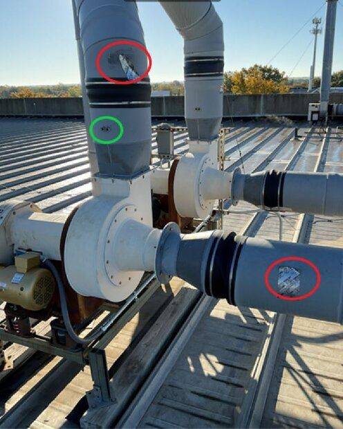

How to Determine Over-Amperage on Pulley Size Change?
In summary, I am having trouble pulling the required 1300 CFM at 7" SP with my VPB-808 fan (rated 4100 RPM) and Baldor, EM3611T, 3HP, rated 1760 RPM, 4.2A motor. My current configuration is using a 1.75" pulley on the fan side and a 2.5" pulley on the motor side. It seems that if I increase my pulley size any bigger, I may cause the motor to be overamped. Would it cause the same over-amperage effect if I decrease the pulley size on the fan side (to
Haotranphotomask
I have a VPB-808 Fan (rated 4100 RPM) from Viron. I am currently trying to pull 1300 CFM at 7" SP, which needs ~2668 RPM (2.85 HP). I have a pulley drive motor (Baldor, EM3611T, 3HP, rated 1760 RPM, 4.2A). It is drawing about 2.8A with the following configurations. It is currently only blowing about 950 CFM.
I currently have pulley sizes of 1.75" (fan) vs 2.5" (motor).
It seems that if I increase my pulley size any bigger, I may cause the motor to be overamped. Would it cause the same over-amperage effect if I decrease the pulley size on the fan side (to 1.5")?
What would be the best course of action? Change the motor? I had the impression that I would have enough power as my motor is rated at 3HP.
The ratio of RPM between the motor and fan needs to be 1.5. Therefore you need a 3 inch dia. pully on the motor and a 2 inch on the fan. 3/2=1.5.
Check the amps pulled by the motor with this combination to see if you are over driving the motor.

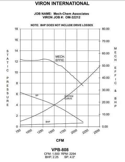

Yeah... did you try to calculate a system curve, or did you just say by fiat "its 7" WC at 1300 CFM?
Because if you are measuring 7" WC now at 950 CFM , at 1300 CFM the system is going to require ( assuming negligible static elevation head )
$$ H \approx \frac {7} {950^2} Q^2 = \frac{7}{950^2}1300^2 \approx 13.1 \rm{ WC} $$
https://vironintl.com/wp-content/uploads/2016/02/Viron-VPB-Series-Push-Exhaust-Blower.pdf
according to the fan data sheet that clock in at about ##5 \, \rm{Hp} @ 3443 \, \rm{RPM}##

You can also make a rudimentary plot of the fan curve from the data sheets at ##\approx## 2660 RPM. If you are actually spinning 2660 RPM, and running 950 CFM then the static pressure should be between 7" WC - 8"WC according to the data sheets. Closer to 8" WC.
Just replace the 7 with the 8
$$H(1300) \approx \frac{8}{950^2}Q^2 = \frac{8}{950^2}1300^2 = 15 \, \rm{in WC}$$
So you are going to have to spin that fan significantly faster with a higher Hp motor if you truly want 1300 CFM
Looks like about 6 Hp @ 3600 RPM
A 7.5 Hp motor is probably where you are going to want to be.

One of my projects 54" Diameter FRP Fan, mounted on a 100+ year old roof with a 5000 lbf concrete inertia base for a HCL scrubber system that was significantly underperforming at the time ( nonone likes breathing HCL fumes) . The fan I specked had a 200 Hp motor, everyone thought I was a fool ( a.k.a. young engineer) which was completely justified.
I did take some licks on that one ( kind of ). The electrical engineers specified the starter, it was a 16 hr day on install day. Everything finally got hooked up around 10 pm. Everyone held their breath and somewhat timidly flipped the switch ( it was the largest motor in the mill ). Seemed to start fine, relief!... then the breaker kicked...and again...ok let's change the wiring on the motor one of the electricians devised. And ...the breaker still popped. That was a depressing moment...I thought, welp... I'm getting the axe ( everyone else joked - but I could see by the color of their face that it was a real possibility). Luckily I had finished early in shutdown week. The next day we determined it was a significantly undersized started. We needed one rated for high inertia loads. That solved the problem.
Likes Lnewqban
Similarly, I'd caution against using the fan curve to estimate static pressure on a system already believed to be performing unexpectedly. It needs to be measured. There are system effects (bad duct configurations) that can reduce the efficiency of fans.

You can look at it the other way, and assume the fan design condition is a correct case. In that case, a measured 950CFM would correspond to about 3.7 inches water. In both cases, there is a problem with the static pressure and/or the flow measurement. I am going to assume that the field amperage measurement is likely correct, since it was probably taken by a device used in other locations (so probably accurate), and it will be the one that sets the upper limit as a constraint. If the amperage/HP of the motor reading is incorrect, then my advice is not helpful.
Sheave (pulley) changes may be more inexpensive than installing new power monitors and accurate air flow devices. In this situation, with questionable flow and pressure, I would use the current fan design case (2668 RPM at measured 2.8A), and, assuming a power factor of 1 at constant voltage (be careful--talk to your site EE about this), calculate a new RPM corresponding to something close to 90% of motor rated power. When I do this, I get a speed required to achieve the new load as ~2,950 RPM using affinity laws (check my arithmetic).
After this change, get new pressure, flow and amperage measurements. The change should help to indicate which measurement(s) is/are incorrect. If it is still not clear, and you need more data, push the load closer to the maximum. You should get about 1090 CFM@3050RPM (est Full load), or 1140CFM@3200RPM (full load +.15 service factor). Even with constraints on the system that are unknown or unmeasured, if the system behaves as expected, you know that a larger motor is a solution (maybe not the best one) until the flow, pressure, and power are more certain, and system issues that deviate from design expectations can be identified.

And actually, I was basing that off of measured 7 inWC @ 950 CFM in the present system. So it can't be reversed like that.

Thank you everyone for the information.
This is the first time I work on an exhaust system, so I have not considered a lot of the information given on here. They were really helpful.
Just to give a bit of history: The blowers were previously designed to flow 1500 CFM at 4"WC (based on nameplate). When the blowers were abandoned in place, they were underperforming. Then we decided to change the motor. Measurements made sense, until recently when we tied it in to our new exhaust system. We consulted a few places and they all agreed that these fans will work on the new system (theoretically), with the current setup. But now the fans are not performing right.
I need to find out the root cause before proposing to get a new motor, or else my boss will be on my ass.

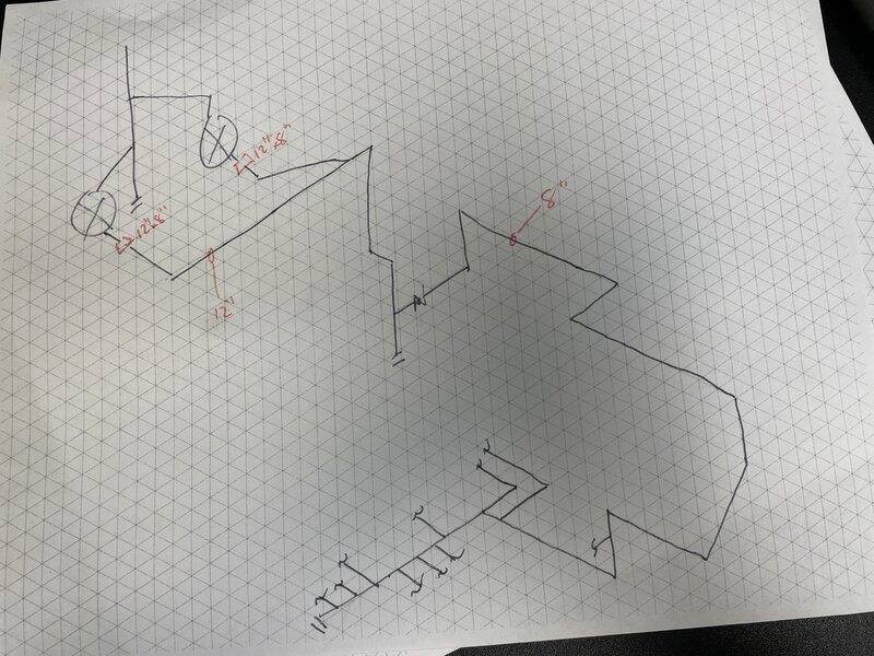

erobz said:
What is the total system layout? Thats kind of big thing not to mention until this point.
We have a tool that requires 1300 CFM of exhaust that was previously tied to another exhaust system. They were running into problem with that system, so they decided to move that tool's exhaust trunk to the fans (the fans in this thread, one of them is a spare) that are abandoned in place. The system that was previously tied to these fans are no longer in operation and the tie-in trunk was capped for the tie in of the new tool.
The tool itself has about 11 exhaust lines, all tied into an 8" trunk. This trunk has about 200 ft of piping and 12 elbows. Then it's expanded to a 12" trunk (about 20 ft with 4 elbows). Then it's reduced to the inlet of the fans.
The discharge side is pretty much just a straight 15ft 12" line.

Consider that the poor fan is working in a sucking-from-many-points situation, rather than pushing air, which is its best performance configuration and design assumption.
It can only create certain lower-than-atmospheric pressure in its inlet; the rest of the moving-air-work is done by the atmosphere pushing air through many inlets, duct branches and changes of direction and toward that unique low pressure zone.
Multi-brach exhaust duct systems need to be tested and balanced, as well as carefully sealed from undesired leaks.
Otherwise, your piece of equipment could be “feeling” only a fraction of the exhaust efforts of your motor and fan.
With enough upstream restriction, the fan could be operating to a minimum flow (like having a close upstream damper), way off the desired operational point.

That configuration is nearly impossible, as how far the fan was built from the tool.
The actual static pressure measured is ~5.5 inWC @ 950 CFM. So using the equation you provided, we may need an increased motor for 10 inWC @ 1300 CFM.
Can you determine if that operating point is on your fan curve @ 2668 RPM?
Likes russ_watters
  • #35
The current fan curve I have is for the old system. The manufacturer has not been quite responsive about providing new fan curves.
