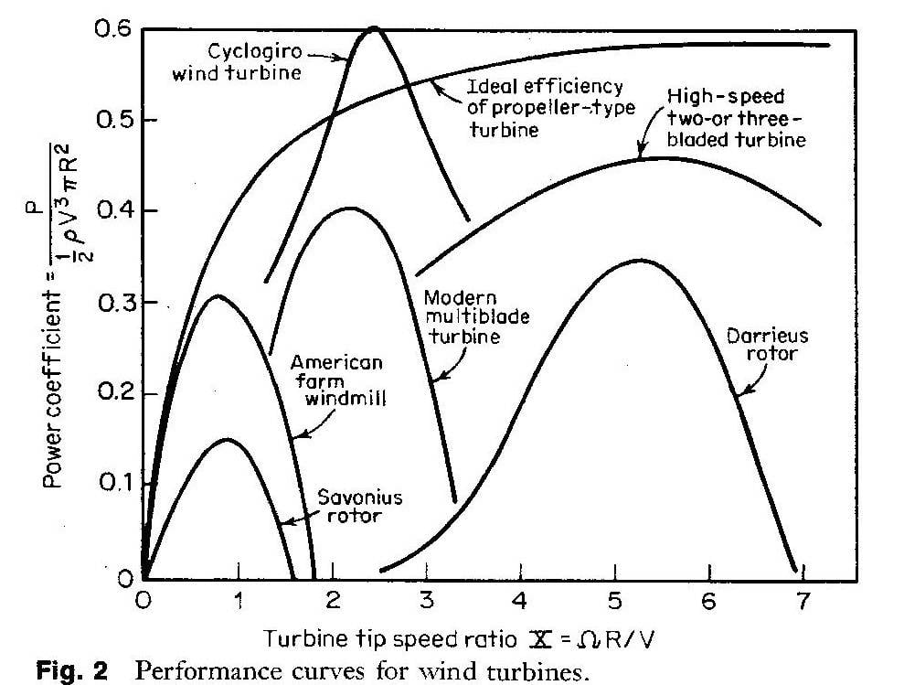

The wind velocity and the blade tip velocity are related. A quick trip to Google says that, unsurprisingly, the ratio between the two is a factor in performance. Here is a useful link.
If you know the wind speed and the tip speed ratio, you know the tip speed.
If you know how much power you are planning to get and you know the wind speed and rough efficiency then you can calculate the required cross-sectional area of your turbine.
If you know the cross-sectional area of your turbine then you know the blade radius.
If you know the tip speed and the blade radius then you know the rpm.

My old copy of Marks' Standard Handbook for Mechanical Engineers Eighth Edition has a section on wind turbines which includes the following chart:
Check out a newer edition of that book, and also some of the references in the wind turbine section.
MTA: Plus what @jbriggs444 said.
This is a little out of date - a modern horizontal axis three bladed turbine tends to run a tip speed ratio of around 9 or 10, which is well off the right side of your chart. I'm not sure why they list a "modern multiblade turbine" at a TSR of only 2 or so - that's never been true of any decent horizontal axis design, even going back a few decades to small designs in the realm of a few hundred KW.
That having been said, TSR is absolutely a great place to start for this. You can't just ask what RPM your turbine will have - that depends on blade angle, generator characteristics, aerodynamic properties, etc. Instead, you should assume a tip speed ratio (5-7 might be a good place to start) and set up your blade angles appropriately. You can then figure out what kind of torque you need your generator to have based on power and RPM, and work from there.
