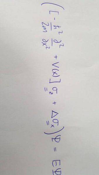

So I have previously learned how to discretize the Schrödinger equation on the form:
(p^2/2m + V)ψ = Eψ
, where the second order derivative is approximated as:
i+1i-1-2ψi)/2Δx
Such that the whole equation can be translated into a matrix eigenvalue-equation.
The problem is that I am now studying systems with spin of the type shown on the picture, where the spatial terms p^2/2m, V etc. can also enter in the non-diagonal elements of 2x2 matrices.
What is the procedure for discretizing equations of this type, if there is any?
The wave function now has two components, corresponding to the two spin projections.
You can treat it as a system of two coupled equations, one for each spin component, but this is better suited for the time-dependent Schrödinger equation. For the time-independent case, you can write the discretized wave function as a long vector, containing for example all the values for spin-up at each grid point followed by all the values for spin-down at each grid point. You can also put them in order of grid point, with one element each for each spin component (thinking about, I guess the latter is better as it will give a banded matrix for the Hamiltonian, which is easier/faster to work with).
