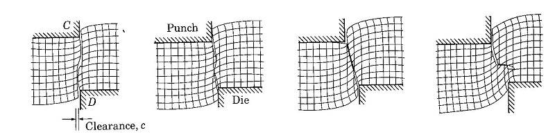

In addition to the previous posts, look at the sharpness of the punch and die, and the clearance between the punch and die. The figure below, from Manufacturing Processes for Engineering Materials, by Serope Kalpakjian, shows the effect of changing the punch/die clearance on the size of the deformation zone.
The deformation zone has high residual stress. The larger the zone of high residual stress, the greater the tendency to warp the finished product. The sharpness of the punch and die also affect the size and amount of the residual stress zone. The book has additional discussion on the subject. I recommend that you get that book, or a similar one, for your personal library.
Likes berkeman and Lnewqban
