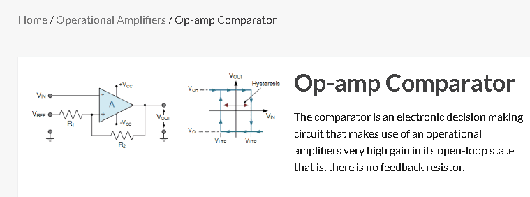

I have an operational amplifier. I am
Trying to make a comparator out of
It. I built a voltage divider to provide
Different voltages. But I either get
The same voltage output regardless
Of input or the voltage is too high I think. How do you make a comparator out of an operational amplifier?
An op-amp is designed to operate with the both inputs at very similar voltages, with an output that rises and falls in a predictable way.
A comparator is designed to work with big input difference voltages, and to provide a small amount of hysteresis. The digital output of a comparator will switch quickly between high or low states.
To get hysteresis from an op-amp you will need to use an input resistor of 1k to the (+)input and a feedback resistor of 100k between the op-amp output and the (+)input. But that will only work if the voltage input has a low impedance.
https://en.wikipedia.org/wiki/Schmitt_trigger#Op-amp_implementations
Could you post a sketch showing all connections to your opamp?
search on opamp tutorial comparator
one of many returnshttps://www.electronics-tutorials.ws/opamp/op-amp-comparator.html

David Lopez: Regarding Baluncore's
and jim hardy's schematic, what values are you using for R1 and R2, Vcc and -Vcc, and Vref? And what is/was the
? I know opamps, but I need to know the above to help.
