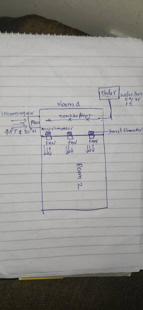

Hy. I was working on a project to reduce humidity levels through mist eliminators. I have a room 1 that intakes air and i spray coolled mist to the same room 1. At the end of the room there is a fan and mist eliminator. What i was thinking is when air temp outside is 45 degree and humidity is 85% percentage, to achive dew point we need to reduce only 4 degree celecious. To do this i pass cooled water to the foger (using chiller) room 1. Then i pass this air through mist eliminator to room 2.

Why are you spraying mist into an airstream you want to dehumidify? It seems like you are doing the opposite of what you really want. And why isn't the answer just "air conditioner"? You seem to be leaving out a lot of important details. Please give a complete description of the application and known constraints.
I want to implement this in a greenhouse for agriculture. Its not a project for schools. Outside temperature is 45 degree and relative humidity is 85%. Mist eliminator only collects water droplets not fog, or it canot collect water from a normal air. So i was planning to add moisture to make airstream to reach dew point and collect this water using mist eliminators.

This approach will increase the humidity past saturation and then collect the excess mist, leaving the air at 100% RH.

You would get better results if you sent the cooled water from the chiller thru a heat exchanger, maybe something like a radiator from a car or truck.
Then a fan could blow air thru the heat exchanger, radiator, and you have cool air.
That is about how air conditioners work.

I agree. If he OP has a mechanism for producing cold droplets of air then it will involve a heat exchanger (/condenser / something) . At some stage, the water droplets will need to be collected and pumped away before they heat up and start to evaporate which could take you back to square one. So why not just condense the water directly from the air to the surface of the heat exchanger.
