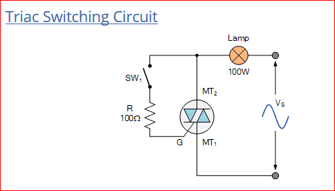

I built the triac switching circuit and tested the old triac which tested good. Well...it worked the way the the schematic said to test it.
I am starting to think that perhaps there is no gate voltage for a reason. The triac is acting as a safety device based on some fault in the amp. How that would work I have no idea at the moment.
Diode D402 was shorted which is a 1n4002. I replaced it with a 1n4004 as I did not have a 4002 on hand. I don't think it matters much as the only difference is the max voltage.
I will study the schematic a bit more and do some testing tonight.

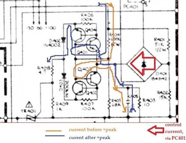

Okay some USWAGS here, Unscientific-Wild-A**-Guesses ..
what the heck is this on the transformer ? Maybe others have a better idea..
I think it's the source of gate current for the Triac.
D401 is a full wave bridge. Its AC corners are left and right, DC are the vertical ones.
Current through that bridge is allowed, disallowed, or modulated by PC401 above.
That current flows out the left corner of D401 into Q401 (or Q403 depending on which half cycle) ,
and on out through Q404 & D402(or Q402 &D403) into the gate.
Need about 50 ma of gate current to trigger the triac you linked.
http://www.datasheet.hk/view_online.php?id=1927120&file=0465\sm16gz41_6629879.pdf
So how does gate current get into that bridge's AC side ?
Here's the only way i can see...
You can squeeze 50 ma peak through R401 if it's 5.1K but not if it's 51 K.
Is it green-brown-red or is it green-brown-orange?
Must tap into a transformer winding someplace ?
Aha ! Near its bottom would be like the test circuit you used...as soon as the triac fires, you no longer need gate drive that's how they get away with only 1/2 watt R401.
The thermal gizmo that looks like two shepherd's hooks, might shut down the amp in case of overheated transformer by removing gate drive.
Power switch does same thing by shorting gate drive to ground at bridge output?
LOL a power switch that's open to apply power ? Showoffs !
Anyhow that's my USWAG. I'll wait for comments from the guys who know this stuff better than me to chime in.
Gotta help Fair Anne with some stuff .. TTFN ...
old jim

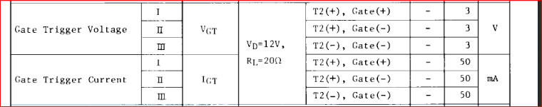

i think the Triac's datasheet tells us here
it's voltage between gate and T1 that fires(triggers) the triac by pushing current into the gate
guaranteed 3 volts and 50 milliamps will fire it at 25°C
but it might fire at much less, anywhere in the shaded area.
(You'll love your new SCR manual...)
Planobilly said:
There is 120V AC at T1 and T2 of the triac
Do you mean between T1 and T2 ? Across the triac? That means it's not turning on, which you know already.
You need a very few volts between gate (terminal 1) and T1 (terminal 2). That's where R409 is connected, from gate to T1. Gate current has to come in from above, via R408 and D402 (or D403).
Now - R408 is only 4.7 ohms. That you found D402 shorted suggests it saw excessive current. If it did, that current also went through R408.
Is R408 still 4.7 ohms ? I'd not be surprised to find it swollen , cracked and open circuit.
How's D403?

Aha ! at 460% magnification, R404 is 6800 not 680K. There's how gate current gets into the four-transistor trigger circuit Q401-404, not through R401 like i drew it...
Planobilly - is R404 blue-bray-red not blue-gray-yellow?
so here's my first shot at the gate drive circuit - doubtless wrong but can be corrected and polished up.
C405 causes voltage at Q401& 403's emitters to lag that at their bases by a small fraction of a cycle..
Between zero and 90 degrees while voltage is rising,
...Q401 is held off , its eb is reverse biased.
...Q403 is turned ON but D403 blocks gate current.
After 90 degrees when voltage starts decreasing from peak the situation reverses.
...Q401 is now forward biased and Q403 reverse...
...Q401 and 402 deliver gate current to the triac
So it CAN bootstrap up
AND we have achieved phase control because
Current from the right, controlled by optocoupler, advances or retards the firing angle.
Closing power switch sinks all the current that can get in through R404 removing gate drive.
So - R404, C405 and D401/PC301 are the muscle of phase control. Brains are in that column of opamps above.
R404 sees full voltage when system is off. Likely candidate to be open.R401 and R402 drop voltage to something within the photocoupler's 55 volt rating?
Sound plausible guys? You were doubtless there already...
old jim
Edit back to drawing board
R404 is 680K per partslist
so i do not see how that circuit as drawn can deliver trigger current more than peak volts/R401,
170v/51k = about 3 milliamps.
Does it use the charge stored in C405 for a trigger pulse?
dv/dt = I/C , it could deliver 50 ma for 10 microseconds with a 3.3 volt drop...
How to check C405 in circuit ?
Check my arithmetic, not to mention the logic.

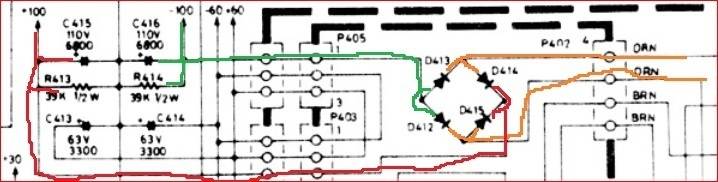

It's just a phase control like a lamp dimmer but instead of a knob it uses that D401/PC401 to control firing angle.
Observe PC401 is under control of the opamp just above.
That opamp's inputs include power supply voltages, and via the heavy dark line a measure of the output.
So i'll correct my last sketch
Good work PlanoBill

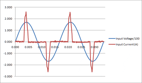

the thing that still haunts me is were he talks about that a unregulated transformer passes current through only at the peaks of a sinus , isn't that BS?
no, it's not BS...
Think about a transformer and simple bridge rectifier with capacitor filter
Current flows only during that portion of the cycle where voltage from the transformer exceeds voltage on the filter capacitor. Rest of the cycle the diode is reverse biased. That is the narrow shaded area under the sinewave peak in Carver's drawing.
Here's an example
http://arduino.stackexchange.com/questions/873/reading-a-varying-voltage-into-arduino
That sharp pointy waveform has a high RMS heating value for its average value so it requires big wire
which requires a big core to surround it
I suspect he uses a much smaller transformer than would be required for 1000 watts continuous, and his smart amplifier overloads it only for brief intervals.. hence thermal sensing on the transformer.
But that's only a suspicion - I've never seen the inside of a Carver.
read up on "Crest Factor"

ok right, stupid me , thanks for pointing that out.I was thinking all the time of a transformer with no bridge rectifier and filter caps at the secondary but those added they do change the picture , hence everything having capacitors also talks about power factor.
according to this graph then we could just use a simply TRIAC for every mains transformer operated psu in it's primary even without the input signal control over it , simply cut off the very starts of rise and fall on each cycle since they would rarely ever go to the cap bank , unless it's being driven so hard the caps are empty almost all the time but that would be beyond hard clipping and distortion anyway.
and so get away with smaller transformers for the same power output ,
why don't others do that ? especially considering the tiny price a thyristor has compared to copper and iron.
  • #62
See ? You knew already... Much of learning is discovering what we know.
