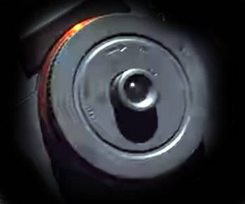

Hello all
As an experiment I tried to make a lens for my dslr with plastic lens of a Kodak Funsaver disposable camera. The lens in this camera is convex-concave and is a 30 mm lens.
Problem is: My lens can only show items in focus if they are at about 1-2 cm away from it. Nothing past 2 cm will be focused. While the lens functioned in the disposable camera.
I have tested by looking through it and on a dslr. Same results.
What could be wrong? There are dozens of videos on youtube showing how the same lens and procedure has worked for others.
thanks in advance
ps The photo shows how these lenses are made.

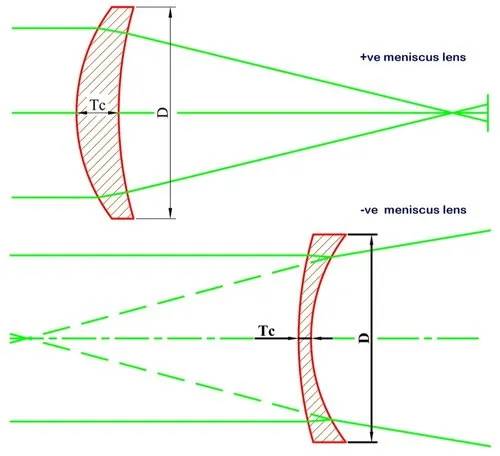

I have been trying to find a diagram that shows passage of light through such a lens and see how objects at different distances should look (attached). I can't figure out anything from it.
BvU I would greatly appreciate if you can attach a diagram that shows how an arrow supposed to look like through such a lens at say 2 m distance.

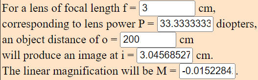

BvU said:
With the lens only (plus a light bulb or something as object and a piece of paper as screen) you should be able to confirm the 3 cm focal distance and a linear magnification of -1 at o = 2f.
mutandi: set i = 30.45 mm. With f = 30 you get o = 2000. Magnification -30.15/2000 = -0.015
So a 200 mm arrow will yield an inverted real image of 3 mm on the sensor
You don't even have to do the calculation yourself :smile: :

BuV I mentioned that this is a covex-concave lens which does not look like the lens in the link. It's been a while since my high school days but I think the two lenses are different. Thanks anyways.
Darkkit lens in its original housing with the original diaphragm (f10) is mounted in a camera body cap that I drill a hole (#16) to pass the housing through. There is nothing in between lens and sensor.
