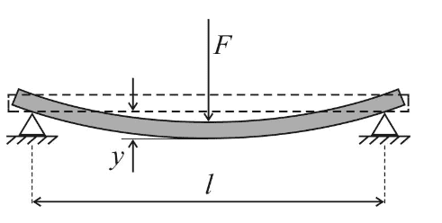

If we have a rod shown on the picture below, we can calculate Young's modulus as ##E =\frac{F l^3}{4yab^3}##, where ##a## is a width and ##b## is a height of the rod.
Now my question is: If the rod is already bended with a certain ##y## as on the picture and if we apply an another additional force ##F'## and the total bend would be ##y'##, can we use in the formula to calculate ##E## only ##F'## and ##y'-y##? Or do we have to use ##F+F'## and ##y'##?
The picture:
Notice that the deflection is linear with force.
Each force causes a proportional deflection.
So long as the deflection is small, the order of application is not critical.

You can use superposition if the deflections are not too large.
You can reson this one out. Suppose that there is not load, i.e. both ##F## and ##F'## are zero. What does the rod look like? Now add ##F## and ##F'##. How would you calculate the height? You may or may not have to ignore the bending of the rod under its weight.

Quick question- are F and F' applied at the same location?
