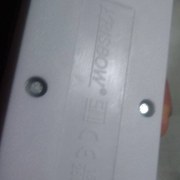

How do we unscrew a screw with no inner screw pattern?
Just saw one on other place so is not on hand now, it has no engraved pattern at all hopefully its pic, could be brought in

Very likely, some white thing around it, suspect it's like common hot glue. It's on China Krisbow outlet extension plug having 3 parallel plugs
Can you post a picture? You can use the "Attach files" button below the Edit window to upload a JPEG or PDF file.

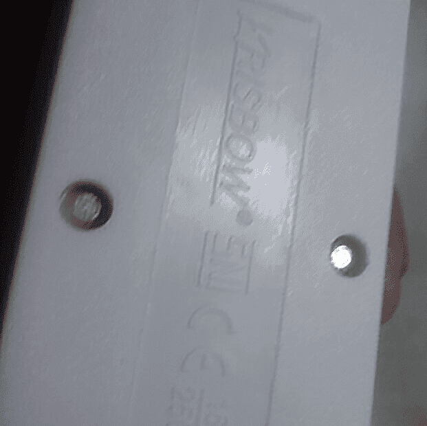

Here is a "re-focused" copy of the image with a little more detail:
Two possibilities here:
(1)
Those look like rivets. Your best bet is to drill them out using a slightly oversized drill bit. Oversized because often the body of the rivet is also expanded, so you have to get slightly below the head.
Even then, you may have to drive the rivet out because the rest of the body has also expanded to a tight fit in the hole. This occurs when the rivet is a soft material, used because less force is needed in manufacturing to 'mushroom' the end.
It is often possible to do the operation using a hand-held drill but you WILL need to hold the work in a vice; being plastic you probably will not be able to just clamp it securely enough to the work surface.
(2)
Those could be something like "press screws" (I don't know their correct name), essentially nails with several grooves cut in them, often spiral grooves with a very shallow pitch. There is a hint of grooves on the brightly lit one on the right side of the photo, at about the 7 or 8 o'clock position. If the grooves are there and they have an obvious head on only one end they can be pressed out, or driven out if you do not have a press.
Hope this helps! Please let us know your progress.
By using rivets instead of screws, the manufacturer may have tried to discourage any attempt of disassembling and repair.
How do you plan on putting the assembly back together?
Why are you wanting to take apart an AC Mains extension plug assembly? Sounds a bit dangerous...
Likes Bystander and Lnewqban
Inside it, it's installs some pressing spring for clasping/fastening the 2 metal plug, which is too strongly tight, so try to detach them
Without that spring, the electrical contact may not be good, making it a fire hazard. To avoid danger, leave it alone.
Likes sysprog and berkeman
Since we now know what this OP is asking about, this thread is now closed for safety reasons.
@abdulbadii -- please don't hack into AC Mains stuff.
