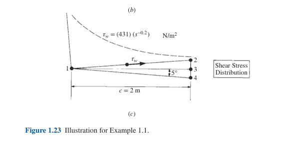

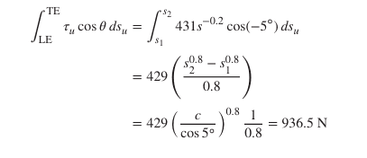

How is
equal to
? How was the 0.8 exponent taken out of the equation to make space for c/cos5?
Thank you in advance. Apologies for the formatting if it was confusing as I am new to this.

It looks like the book integrated ##s^{-0.2}## to ##\dfrac{s^{0.8}}{0.8}## using the usual antiderivative rule for exponents: $$\frac{d}{dx}\big (\frac{x^{n+1}}{n+1} \big) = x^n$$

Hi! I understand that bit on how to integrate but I'm confused about this part: if c/cos5 = s
12, & s12= s2- s1, how is it that s20.8 - s10.8 = s120.8 = (c/cos5)0.8

##\dfrac{c}{\cos 5°}## is the length of ##\overline{14}=\overline{12}## that is the vector in the picture. Maybe it is the mean value theorem of integration.

Hmmmmm. Thank you for replying but after a lot of thinking, I believe the author used s1 to be 0 so it canceled out. This would be the only way that s20.8 = s120.8 = (c/cos5)0.8.
