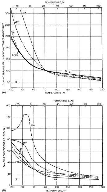

You did a good job of identifying the effect of air resistance. The effect of temperature on the rubber ball interior is a little more complicated. The rubber inside golf balls is an elastomer, and elastomers have properties that vary with temperature. There are two different properties that are most significant:
1) The modulus of elasticity
and
2) Hysteresis, also known as damping
Modulus of elasticity is stretchiness - how much it stretches under a given stress. The modulus of elasticity of elastomers is nonlinear because it is a function of the stress. Hysteresis is energy absorbed and turned into heat during the act of stretching. Both of these properties are a function of temperature. I did not find a plot of material properties for the rubber used in golf balls, but did find on for some random elastomers:
Note that both the elastic modulus (spring rate), and the hysteresis (damping factor) in the above plots vary significantly over the range of temperatures that you mention. The rubber used in golf balls will be different, and there are other elastomers where the properties vary at higher and lower temperatures. Do not use this figure for golf balls.

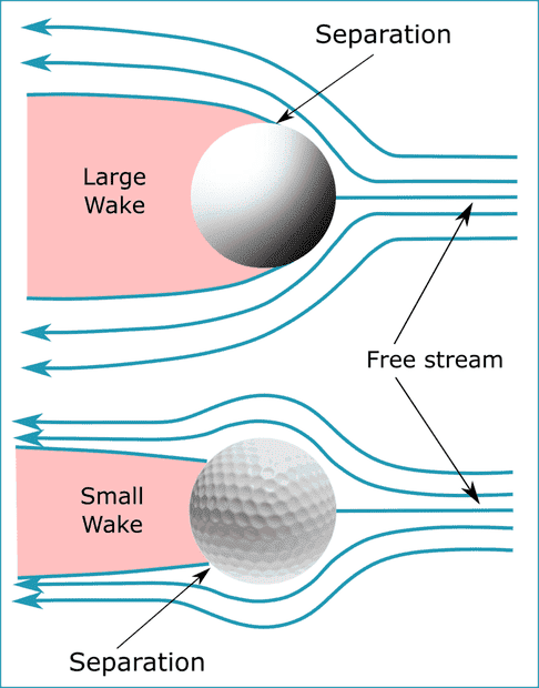

Magnus effect is certainly relevant for distance travelled. But the dimples are as far as I know for the reduction of resistance by reducing the wake:

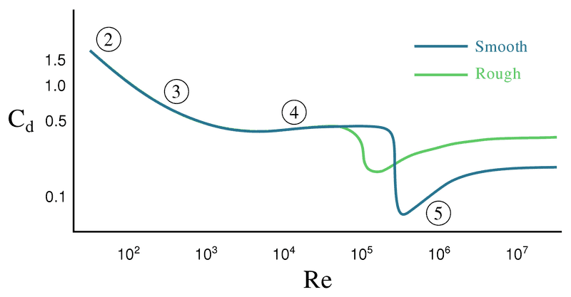

By the way, temperature affects viscosity. And viscosity together with density affect the Reynolds number. And since the drag of a golf ball is dependent on the Reynolds number this will also have some effect, But I think not that big for this case. This is from wikipedia (smooth: no dimples, rough: with dimples, so according to this graph Cd only gets smaller by the dimples in a very specific region of Reynolds numbers... I don't know what's true):
