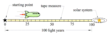

  • #81
Mister T said:
If the tape measure is at rest relative to the solar system, what you say is true [the tape will read distance correctly]. But if I'm holding the tape measure it's at rest relative to me, and what you say is not true.
If the tape travels with you, you won’t be able to measure how far you’ve traveled, or how far away you are from the solar system at each point in time.
If you fix one end of the tape 100 light years from the solar system, and the other end at the solar system, the tape will measure distances correctly both from the Earth, and from the moving ship.
If the tick marks on the tape are one light-minute apart then, looking out the ship’s window, you will see a tick mark go by every (just slightly over a) minute. At high speeds, the numbers will appear close together from the ship's frame, but the distance measurements will still be correct.
  • #82
Sure you will. Suppose you're at the origin of your tape measure. Just observe the solar system's location on your tape measure, and that tells you how far away it is. Observe another one later. Subtract the two readings and that will tell you how far you've traveled between the readings. Relative to the solar system, of course. Which goes without saying because otherwise there's no meaning to the phrase "how far you've traveled".
  • #83
This is not correct. Indeed, it is not possible to make a device which can do that since the Earth and the ship disagree.
  • #85
This would be a strange way to use the word "correct". Using that contracted tape measure you'd conclude that your ship's length is larger than it's proper length.
If you looked out the window on the other side and saw a tape measure moving at a different speed from the other one you'd again get a different length. Maybe this is what people mean by the term length dilation.
  • #86
If the tape measure is subdivided into light-years then, after (just over) one year of Earth time has passed, you should be able to look out the window of your spaceship and see the number "1" go by.
An Earth telescope watching that event will also (when the light reaches the astronomer 99 years later) show you pass by the number "1" on the tape.
  • #87
Of course. But that's measuring distances in the Earth frame. The 1ly divisions won't be a light year apart in the ship frame - so this isn't measuring distance traveled in the ship's frame. Indeed, the ship isn't moving in its own rest frame, so there's no distance traveled to measure.

  • #92
The marks on the tape are always at rest with respect to each other. Assume the ship begins at rest (with respect to the tape). Start the engine and the ship will accelerate. All the marks on the tape move together (with respect to the ship) at the same velocity. The only way for the distance between marks to change would be for one mark to move faster than another.
  • #93
Indeed. Accelerating frames of reference are odd. You may wish to look up Bell's spaceship paradox and its resolution for a related problem with a lot of discussion.
Alternatively, consider that if the different parts of an unaccelerated object don't move at different speeds as seen in your frame as you accelerate, length contraction could never happen.
