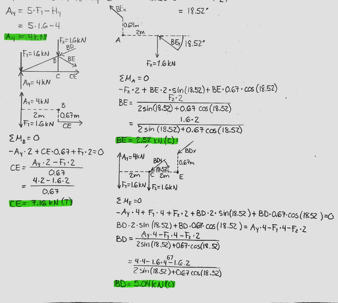

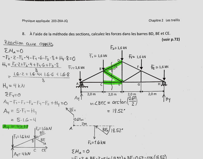

Using Ritter's method of sections, determine the forces in BD, BE and CE
EM=0
I had made a silly inattention mistake. Once corrected everything worked out. I have updated the pictures to show the correct answer.
