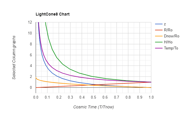

This graph shows ##H## as a function of time related to the L-CDM model. Do we (@Jorrie) have similar graphs e.g. for ##\Lambda=0##; ##k=-1## critical, ##\Lambda=0##; ##k=0## open, ##\Lambda=0##; ##k=+1## closed?
That would be great, thanks in advance.

Not precisely, but you can get close enough for all practical purposes by playing around with the input parameters and output options. E.g. ##\Lambda = 0.0000001##, set the output scaling to Normalized, select Chart and set hor and vert scales appropriately:
For Open and Closed cases, you play around with ##\Omega##. I have used the http://jorrie.epizy.com/docs/index.html?i=1 version, which has more liberal range limits than the approved Github version.

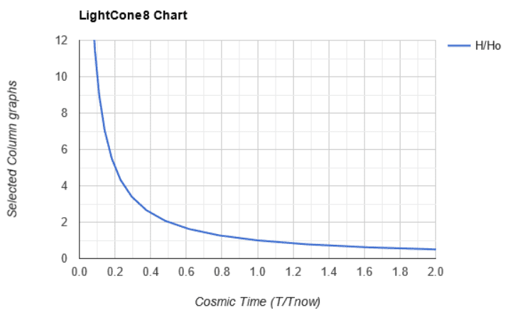

One question, how can I show only one of these curves?
Just go to 'Column definition and selection'. I usually click 'none' and then select the two or three that I need. The default selections are just to give an idea of how it works.
