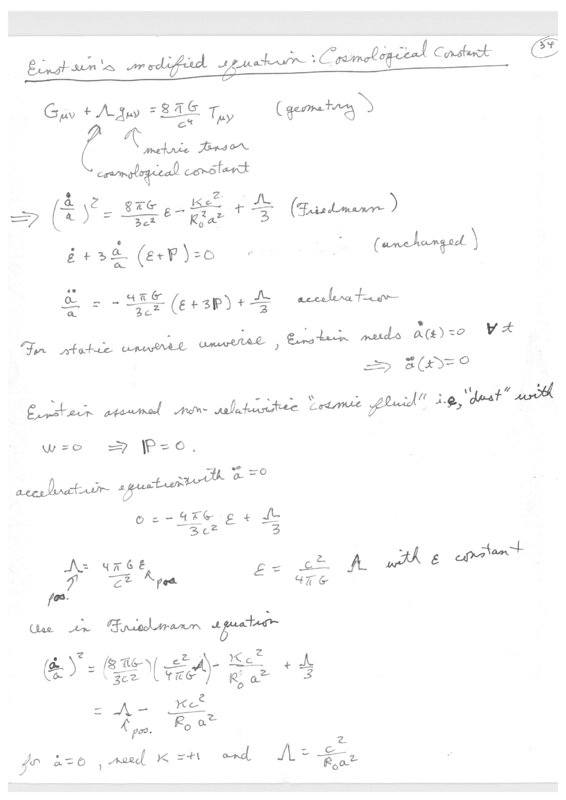

What are you getting at? The static universe has been roundly disproven. It doesn't work theoretically because it's unstable (any inhomogeneity, like a bunch of galaxy clusters, will cause parts of the universe to contract and others to expand forever). It doesn't work observationally because of the observation of the Cosmic Microwave Background (which only works if our universe was much hotter and denser in the distant past).
Hi kimbyd:
My discussion of the 1917 Einstein model was to demonstrate (suggesting a mathematically possible model based on the Friedmann equation) that the cosmological constant could theorectically have a different role than the one Peter mentioned in the first quote. I did not intent that this model would match any currently observed cosmological observations.
Regards,
Buzz

Except the cosmological constant in that model has the exact same role as it does in today's universe. The only difference is one of magnitude.
Hi kimbyd:
I think you are saying that my quote below is a mistake.
Buzz Bloom said:
However, it would seem that in this scenario, the role of ΩΛ would be the "cause" of the stable non-expanding and non-collapsing universe.
If so, please explain in what way what I said in this quote is an error? Einstein reluctantly put the cosmological constant into his 1917 model because he had no reason to believe at that time that the universe was expanding. He included it specifically for the purpose of obtaining a non-expanding universe because his model without the cosmological constant did expand. Therefore, I think it is quite reasonable to say from Einstein's perspective that the role of the cosmological constant was specifically to avoid expanding rather than to make acceleration of expansion happen, as Peter described it.
PeterDonis said:
So the cosmological constant by itself cannot explain the expansion. It can only explain why the expansion is currently accelerating.
Thus whatever in the real world the cosmological constant represents, say X, with what was the state of knowledge at that time, X was the cause of what Einstein thought to be a stable non-expanding universe.
Regards,
Buzz
Matter attracts itself, tending to slow if not reverse the expansion. A cosmological constant tends to push matter apart. That's the role the cosmological constant plays. Whether that results in a universe that collapses back on itself or expands forever still depends upon the precise densities of each as well as the rate of expansion.
Likes Buzz Bloom
