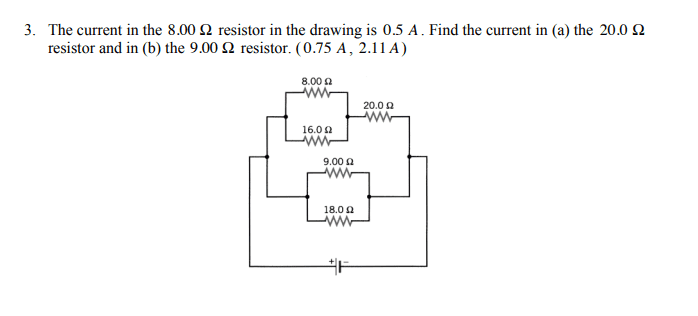

The current in the 8 - ohm resistor in the drawing is 5 A. Find the current in the 20 ohm and 9 - ohm resistor.
V = IR
I'm having difficulties finding the current for a 9-ohm resistor only, not the 20-ohm
My attempt was to find the voltage of a 20ohm resistor which is V = (0.75A)(20-ohm) = 15V. I got the 0.75A by adding the currents of the two resistors (8-ohm and 16-ohm) together that were in parallel and it becomes the current that will flow through the 20-ohm resistor. After getting 15V, I don't know what to do next in order to find the current in the 9 - ohm resistor.
Also, look at the image for more information.

What other voltages can you determine?
4Volts from the parallel circuits with an 8-ohm and 16 - ohm
So what is the voltage across the ##9 \Omega ##|| ##18 \Omega## pair?
that's what I'm looking for in order to find its current next.

What is the relationship between the voltages:
- across the 9Ω|| 18Ω pair
- across the 8Ω|| 16Ω pair
- across the 20Ω resistor

I didn't ask how the voltage across one of a pair compared with the voltage across the other of the pair. I asked about the relationship between the voltage across the 9Ω|| 18Ω pair (taken as a pair), the voltage across the 8Ω|| 16Ω pair (taken as a pair) and the voltage across the 20Ω resistor. Three voltages, one relationship.

Of course I am giving a hint!
Call the voltage at the right of the 20 Ohm resistor 0.
So what is the voltage at the right of the 9||18 pair?
What is the voltage at the left of the 20 Ohm?
So what is the voltage at the left of the 8||16 pair?
So what is the voltage at the left of the 9||18 pair?

K, i got the voltages: 4volts for 8||16 pair, 15V for 20ohm, and 19V for 9||18 pair.
Are they correct?

Yes.
