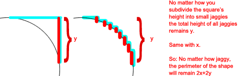

I don't get why this troll physics is wrong.
  • Thread starter LogicX
  • Tags
    Physics
In summary, the conversation discusses the flaw in a particular method of approximating the perimeter of a circle. The method involves removing the corners of a regular polygon inscribed in the circle and finding the limit of the resulting perimeter. However, this method never enters the perimeter of the circle and therefore can never converge to the actual circumference. The conversation also touches on the idea of a "real" or "conventional" length of the circle, and the concept of pi being half the circumference rather than the entire perimeter. Overall, it is concluded that this method is not a valid way of finding the circumference of a circle.

That does not mean the limiting function has an infinite number of jags. That is faulty logic. It just means that the number of jags are increasing without bound for the functions in the sequence. The limiting function need not resemble these.
Consider a similar variant along these lines: You iteratively pick some arbitrary number from the stack of rational numbers. Each pick leaves a new disjoint interval in the rational number line. As you continue, the number of disjoint intervals increase. Still, the "limit" of this process will exhaust the rational numbers since they are countable (given that you actually pick from a list of the rational numbers), leaving no such intervals.

No, its not that simple. The limit of the steps is a curve that converges uniformly to the circle but is nowhere differentiable. In short, it is not the circle.

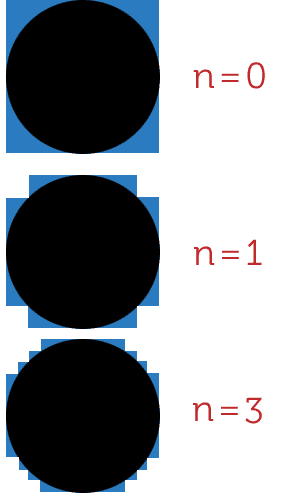

EDIT: THIS IS WRONG. Working on the correct one now.
There is always going to be area between where the "ridges" are and where the outside of the circle lies. That area is given by:
[tex]A = 1 - \pi\ - \frac{4n+4}{n(1 - 2\sqrt{2})}[/tex]
Where n is like this (and A is the blue area):
The limit of the above function as n -> infinity is .0461.
P.S. My constant of [tex] 1 - \pi\ [/tex] may be off. If someone wants to check/correct me on that equation that would be great, I'm a little tired at the moment. If not, I can go over this tomorrow.

it is not true that lim(lengths) = length(limits).
the (euclidean) length of a curve is not well-defined on the set of all possible curves. the notion of length, can be counter-intuitive, it depends on 2 things: what you are measuring, and how you measure it. the various fractal curves give examples of how length can be "worse than it looks" (the koch snowflake, for example. its length doesn't appear to be infinite).
if you were to produce a specific parametrization (piece-wise) for the "boxed" approximation, you would find that in the limit, it is not differentiable. the differentiability of the parametrizations are a key hypothesis in proving this independence.

Not only that, the derivatives of the parametrizations must themselves converge uniformly to a continuous function. At least this is a sufficient condition, and counter-examples to "limit(length) = length(limit)" where this is not satisfied (while your condition is) exists. E.g: One could easily make the jagged lines around the circle smooth by substituting the tip with a quarter of a circle or something similar, but the lengths would still not converge to the correct value.
And it is not true, as suggested by someone eariler, that the jagged curves around the circle does not converge to the circle. The curves does converge uniformly to the circle, the problem is just that the lengths does not.

Ugh, finally got it. Maybe. Could someone try to do this out themselves?
n is the number of points in each quadrant where there is a point touching the circle. A is the area of the blue. See below image for sample. Basically, there is always going to be area surrounding the circle that is blue.
Equation:
[PLAIN]http://www4b.wolframalpha.com/Calculate/MSP/MSP67019f5i3id7f23f46800006a6bfeede1b8g0ih?MSPStoreType=image/gif&s=30&w=215&h=61
lim x->infinity = 1-(pi/4) = original area of blue when n=0. But I don't understand how that could be the case. I think the above equation must be wrong. I'll have another look tomorrow. I suppose it could make sense when there are thousands of points touching the circle, but I don't think so.

Alright, I'll post the derivation I did. I'm almost 100% sure there's a mistake in here, so please try to help.
Let's say that n is the number of times a white "corner" touches the black circle in one of it's quadrants. See previous image above for a guide. For simplicity's sake, let's only focus on one quadrant for now. We can multiply it by 4 to get the total area lost later.
Now, to get the area lost (in each quadrant) by having n number of touches (in each quadrant).
I THINK we can break the whiteness up into even squares. The amount of squares along the top row is simply n, and the amount of squares along the outside column is also n. This means (I THINK) we can get the total number of squares for touches n by using the triangular number formula (but I could be wrong because the circle being a curved surface might change this).
[tex]\frac{n^2+n}{2}[/tex]
So that is the total number of squares lost in each quadrant. Now, let's get the area of each of those squares. Let's focus now on the corner-to-circle touch on the edge of the quadrant. (in quadrant 1, it would be the farthest right touch).
First, we should simply get the angle on the circle where this touch is. cos(theta) gives us the distance from that touch to where the top edge of the original square was (if n=0 and there were no touches). sin(theta) gives us the distance from that touch to the right edge of the original square was (in quadrant 1, but that's all we have to worry about for now). That means, to get theta, all we have to do is:
[tex]n(sin(\theta)) = cos(\theta)[/tex]
Now, let's get the distance from where theta lies on the outside of the circle to the edge of where the original square would be. This will give us the length of each side of each square. This equation is:
[tex]L = \frac{1}{2} - \frac{cos(\theta)}{2}[/tex]
After some simplifying and combining the previous two equations, we get
[tex]L = \frac{1}{2} - \frac{n}{2\sqrt{n^2-1}}[/tex]
The original area with just the original square and circle is just 1- pi/4. Let's square the L in the equation above to get the area of each square, then multiply it by the triangular number formula (giving us the total area subtracted from each quadrant), then multiply that by 4 to get the resulting area subtracted from the entire figure. After all this, we get this:
WolframAlpha equation
I'm almost certain my math is correct, it's just the concept. I'm not sure if we can count every square as having the same area, and I'm not sure if we can simply use the triangular number equation due to the nature of the circle being curved.
If someone could take a look at this that would be great, because I'm stuck, and not to mention kind of sick of working on this problem myself.
Thanks.

As I've mentioned, for each iteration of removing squares (which I will call cycles), the area will differ. (i.e. the second and third squares removed will be smaller than the first square removed). In fact it gets more complicated than that. For each removal cycle you will remove 2 squares near the edge of the quadrant and you will remove squares interior to the quadrant. These squares will also have different areas in fact. This effect will build up and for later cycles there may be several different sizes in a single cycle (the two most interior squares share an area, then pairwise as you progress outwards of the quadrant). You cannot simply take every square to be the same size.
  • #70
My equation takes all of that into account, except for the fact that the squares change size. If someone could derive the right equation I'd love to see it.
