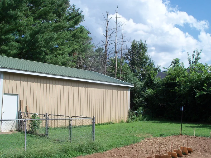

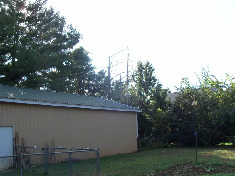

I need to cut down a 3 year old dead tree from top down so tree causes no damage with small pieces falling. I need a mirror with a focal length of 150 ft. 12" diameter to 36" diameter will work good but I can't think of any easy way to build it. Nothing like this for sale on Ebay.
I have a 30" Fresnel lens that I use to burn stumps it works great.
Tree service wants $2000.

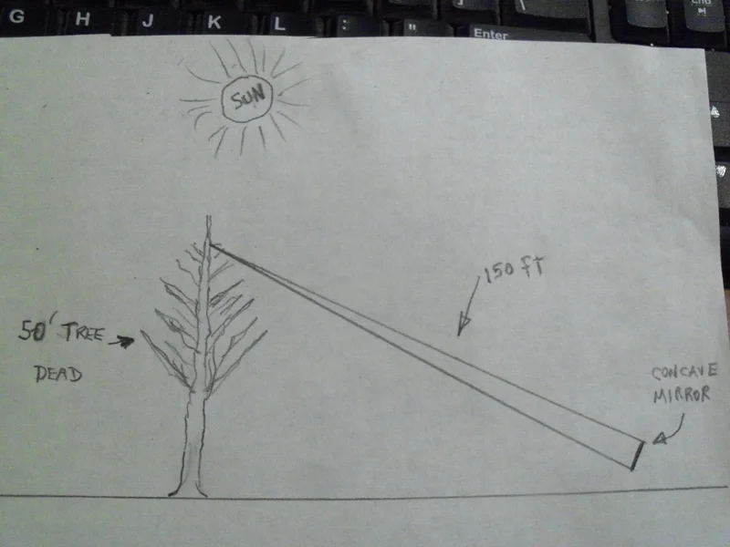

Your mirror will be close to flat, so it does not really matter if it is a parabola, a sphere or an ellipse.
You could use many smaller flat mirrors, mounted Fresnel like, on a flat surface, maybe plywood with a pyramid back frame to prevent twisting. Calculate the spacers needed on the plywood face, to tilt the mirrors at the correct angles.

Better to consider felling in the normal way. 50ft is not high, plus you say it's dead. Two ropes pulling in a V, attached as high up as you can get (and a tether near the cut to stop the base from leaping about when it goes ), would protect neighbours. 2K is an awful lot to pay. It could be a lot cheaper if you shopped around
PS is the tree really as fat as your sketch suggests?
By the picture they look too old to be climbable, so that may be a reasonable price.
Renting a truck/van with a bucket arm (and a fellow who knows how to use it) looks like a good idea.

$2k seems excessive. I wonder if that estimate was based on a visit or accurate photo?

I don't know the local prices, but when the tree is too old or damaged to be trivially climbable the price usually goes up.
Especially if it is a damage sensitive job (close to a building).

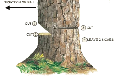

Baluncore said:
When you attach a single rope to a tree, in an attempt to pull it down in a preferred direction, it will usually fall left or right, at 90° to the rope.
I have never heard of this. A tree that is evenly loaded branch-wise generally will fall in the direction of the rope/cable if the proper notch and back cut are made. I fell one this way last week. Two man job. One guy on the saw another on a tractor to pull. Once the tree starts to tip it's pretty much decided that's the direction it will go. It is important to make the notch large enough so the hinge does not break off too soon. Also, cut above the notch several inches when cutting from the back. Like this:
Cutting even with the notch is dangerous. It is more likely for the trunk to split and the back of the trunk above where the cut is being made will snap outwards in an instant. I know of people seriously hurt or killed from this. Also, if a tree does fall to the side of the direction desired the reason is likely because there is severe side load that should have been dealt with prior, or the back cut was made too low.
As I mentioned, you don't want the notch to break too soon. I've seen teeny tiny notches cut that don't allow the tree to fall far enough before the notch closes up. Two things can happen here. One is that the tree hasn't fallen far enough to put enough strain on the hinge to break it. It hangs up. It is desirable for the saw to be away from the trunk when the hinge breaks. How is this possible at this point? Also the tree is hanging with no good way to determine if/when it will snap. The other thing that can happen is if the hinge does snap the tree is too close to vertical yet and there is a greater chance of the trunk rolling a significant amount before it hits the ground. May or may not be important.
The one I fell last week had a small window of error for the direction. It was right next to a building and other obstacles were around it. It went exactly where we wanted it. It started to pinch the saw on the back cut so we put a little tension on the cable. At that point there was no turning around. It fell perfectly.
That was a well-balanced tree with a flexible hinge, so you could have used a wedge in the back cut, rather than a rope. The problem comes when people use a rope to pull the tree in a way that it does not want to go. Why else would a beginner have used a rope.
The other problem comes when people use a crane to remove and lower entire limbs from the tree as they are cut free. It is hard to guess the weight of a limb. The limbs removed become progressively bigger, approaching some limit, until the crane cannot support them, and you don't know that until the limb is hanging on the hook. Also, the boom starts elevated close to the crane, then the boom is lowered away from the tree. That increases the moment on the vehicle, again trapping the operator in a crane destroying situation.
It's balance was a little better than I thought it would be. The problem with a wedge in the back is there was no room to swing a hammer against the wedge. Too close to the building. And I wasn't going to take a chance because there was significant loss of limbs on the cable side. I had assumed it would have taken more than a wedge anyway. I was surprised when the cable was pulled slightly and the tree kept moving in the correct direction. We just kept ahead of it with tension until it was well into the fall. Took place in about a second or two.

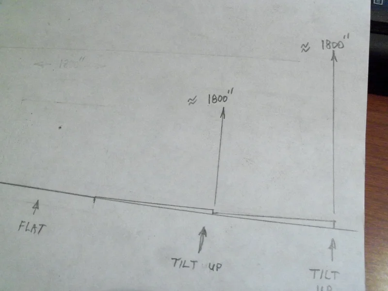

When finished it will look like a Fresnel lens with several circles of 2" mirrors.
Why circles? If the mirrors are rectangular, lay them out in a rectangular grid. You only need to place accurately calculated shim spacers on the flat backing plate, to aim each of them in the correct direction.
It is best to use front silvered mirrors. The cheap alternative would be to use an aluminium foil. Gold leaf is very thin and low cost on eBay, probably cheaper than glass mirrors. You could make your own flat glass plates, each with a gold leaf front surface.

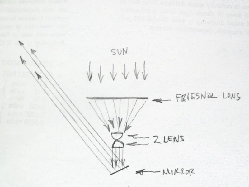

This works.
gary350 said:
This works.
Did you actually make it work? What was the size and focal lengths of the added elements and how big was the image of the Sun at the final focus?
It seems to me that the arrangement in the diagram is the equivalent of a single mirror with a focal length of the original 150 ft.

I think you should mount the lens, fixed and aimed at the target, then track the Sun with a flat-mirror heliostat, mounted on a clock driven axis, parallel to the Earth's axis. The only moving part then is the flat heliostat mirror, and that can be balanced. That is the opposite light path to the one you show.
If this is to be used for several hours, how does the angular range work?
But what about the image size at the focus on the tree? You have even less than 1kW of incident power and an image size of say 4cm diameter. What sort of temperature will that produce? Fine for boiling water but what about "Fahrenheit 451". Tell me if I have got the basic optics wrong. If not, it won't work at that distance.
