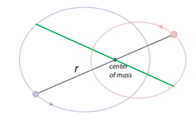

  • #48
Post #42 makes sense about orbits being symmetric when only two bodies are involved.
The CoM of the two bodies won't move since there are no external forces involved. Let's use that as a reference frame then.
The proposed experiment by @Drakkith in #17 necessesarly will look like this if the velocities are below the scape velocity.
Where the green line is to show the position of the bodies after the flyby. I feel like the kinetic energies of the bodies before (black line) and after (green line) should be exactly the same.
If the velocities are high enough (as I believe is the case in proposed simulation in #17 by @Drakkith), the orbits will no longer be elipses and they won't close at their far ends. (I wish I could explain it better but I can't find any diagrams). Still, the same reasoning applies:
@Drakkith do you agree with this? Maybe there is something wrong with the simulation? The results you provided no longer make sense to me. I assume it's being solved numerically. Maybe the acquaricy is being an issue.
Likes jbriggs444
