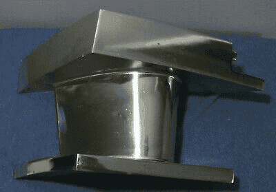

I to design this turbine blade
In summary: I don't know the name of those wings. But I know that they produce the maximum lift in comparison to other kind of wings. They also produce maximum drag that limits the velocity of the plane.

Given above is a rough model of what I want to make. This is in fact a turbine that will be placed in airlfow of 65-70 m/s velocity. I want to make it by using a 3D printer. But I want to use the best design of the blades that will give me highest output out of this airflow. Can anybody tell me how to design blades (like as shown in the photo) so that the design can be fed to a 3D printer. The gap between two rings for my design is 3 cm and the width of the turbine would be 4 cm.
Is that 4 cm width or depth? Is it the chord length of the blades 4 cm?
It looks like you will need to make 9 separate blades. Those will be mounted between the two steel ducts. Or will you fabricate the entire spinner as a single unit?
Each blade will be a 3 cm wide section of airfoil with a chord length of 4 cm. Because the blades are short they will have very little twist.
I just want to make/print the blades and put those in the still frame later. And this is a comparatively shorter model. The model I want to make has 19 cm external and 16 cm internal radius.

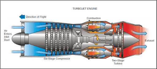

Look at the compressor at the front of a jet engine. There is a dome that keeps the flow entering the compressor clean. The blades will work efficiently only if there is laminar flow over the blade airfoil.

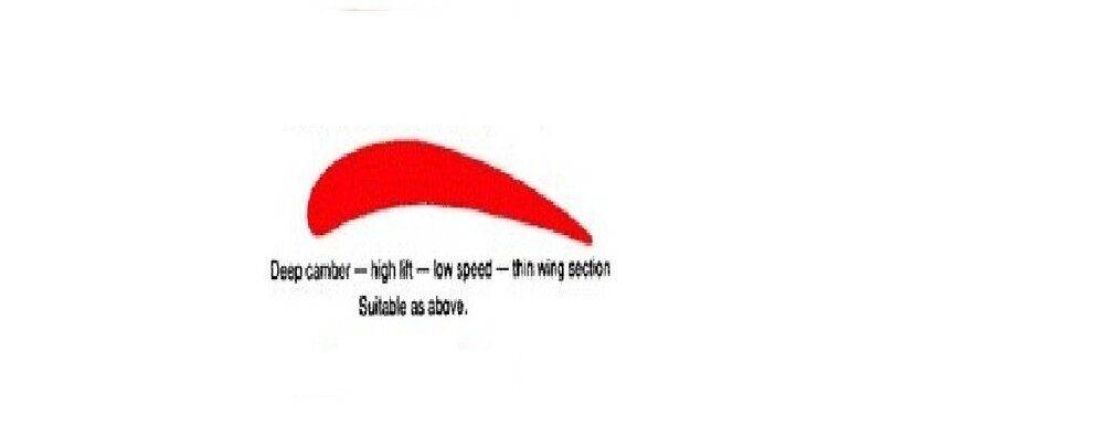

Just found this design from the link. But not sure whether any 3d printing company can make what I want to from this design or not. Kindly help!

Can anybody here at least what this type of wings are named as? Such kind of wings were used in early aircrafts when the velocity of planes are low. Such kind of wings produce the maximum lift in comparison to othe kind of wings. But it also produces maximum drag that limits the velocity of the plane.

They are called buckets, or vanes, not wings.
@Baluncore came closest to what you need. It is analogous to the turbine section of a jet engine.
If you search around online, or perhaps in junkyards, you might find an affordable vane to buy and copy. You might also find a drawing showing the cross section.
But how close this will come to "best design" for your application is guesswork without the detailed calculation. Designs like that don't scale well in size or air velocity. It is up to you decide how confident you need to be that what you have is "best."
Even the number of vanes is not guaranteed to be best. Your picture shows 9.

A very common airfoil is still the Clark Y. Just draw something that looks like that and it will work.
https://en.wikipedia.org/wiki/Clark_Y_airfoil

Those thick high-camber airfoils had the highest lift, but also had very high drag. They were the German style from Gottingen University 100 years ago. The thickness gave more rigidity for early monoplane wings, but greatly reduced the maximum airspeed.

I have chosen one. Kindly see the attached file. It's a high camber more lift type of wing used long ago in low speed aircrafts. Whatsoever, I need just one more help. I can't understand the table 177 given in the attached file. Need help to understand it.
  • The wing.pdf
Do you understand any of it? Those are just geometric properties picked-off of/interpreted from figure 137.
Some, not all. Especially those at the top i.e. Maximum Thickness and Maximum Camber part. Rest is more or less clear.
They are expressed in % of chord and you can read them straight off the graph: 5.9% is 0.059 on the graph. And the X-coordinate is given at 0.21. In other words, if the chord length is 100 cm, the maximum thickness is 5.9 cm.
