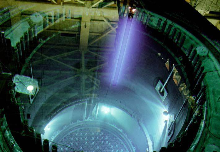

Spent fuel fresh out of the reactor is highly active . Here's an image from Forbes magazine and that's about what they look like... (i was never able to get such a good photo.)
http://www.forbes.com/sites/jamesco...nuclear-power-plant-be-refueled/#7cbfb650482c
The radiation from that fuel element as you see makes the water glow blue,
i daresay nobody would get close enough to measure its level with a meter,
Probably someone here could give you an educated estimate.
Must be thousands of Sv ?
On a practical note - With no water in between it and me, i wouldn't want to be near enough to see it , a few hundred meters.
I hope that gives you at least a gut feel for your question.

That's a great picture of a BWR core. Probably Columbia generating station? It's definitely a "newer" BWR.
That appears to be CGS. I can confirm with the author.
Makes sense. I'm a PWR guy, and we don't leave the head studs in place.
I take it your BWR refueling water is not borated?
Was looking for a good picture of Cherenkov..

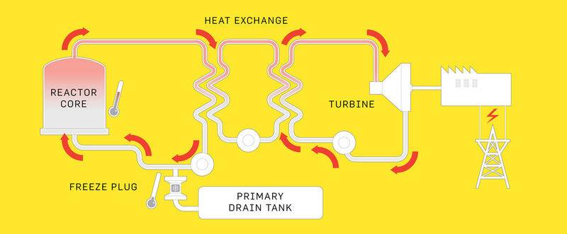

Is there a reactor that redirects some of its energy directly to the active cooling system of it, so that the reactor works without needing any electricity source to power its active cooling system?
And a while ago I have red an article from popular science, there it says there is a reactor type (that hasn't been implemented yet), in which when the meltdown occurs, the molten salts flow into a chamber where it's safely contained, not harming anyone. Why doesn't anyone use this?
"If a reactor loses power, a freeze plug melts, draining the radioactive fuel into a tank where it cools to a solid."
Wait.. Can the radioactive fuel cool to a solid despite it's enormous decay heat?

as for the molten salt reactors and my questions I will wait and let the more experienced forum members answer and I suggest you do the same.

Jim: BWRs don't use boron during refuel. The control rods remain fully inserted in the core, and the spent fuel pool is either spaced to ensure k effective is < 0.95 or boron plated fuel racks are used. During operation, boron injection is only used during ATWS scenarios (failure to scram) at high power/with core instabilities/if containment is challenged. Boron injection can also be used to provide supplemental inventory control during loss of high pressure injection scenarios, and some plants will inject boron to adjust ph of reactor coolant during a LOCA which improves the ability of water to absorb iodine released from fuel damage and minimize offsite release.
In that picture you can see the feedwater spargers (upper rings), and directly next to the top of fuel you can also see the core spray ECCS spargers. The steam lines are also easily visible. This picture has the steam separator and core shroud head removed (to get access to the fuel).

Salvador said:
@Jim and others , is that the spent fuel pond in the photo , or is that part of the active zone of a BWR ?
You are looking down into the core of a BWR through probably thirty feet of water. That element has been lifted out and is en route probably to storage in the spent fuel pond.
I'll let BWR guy address your further questions. My knowledge of BWR's is scant, from a one day introductory class. I don't pretend any expertise on BWR's.
