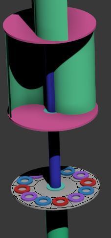

My fault I should have shown how I was planing on laying out the coils. As you can now see
in the picture I attached the coils are represented as those circles below. I have the turbine
lifted away from the coils so you can see them but when done the turbine will float just above
the coils using a magnetic levitation in the middle and I will use a shaft to stabilize the whole thing.
I'll use weight to adjust to get the exact levitation level correct so the turbine with the magnets floats just above the coils of wire. Oh and by the way according to the wire guide 1AMP on 30AWG
wire would break the code / thus burn your wire. That very thin wire is only rated for .86 AMPS.
Hope this makes sense.

Your setting up a standard design for a typical turbine.
Yes, I know that wire I used was small and what it is rated for. It was the only way I could to get the coils flat enough for the thin magnets to have any worthwhile affect. I wasn't suggesting you do the same.
I just told you how mine was setup, that's all. My turbine normally put out about 1/2 amp in operation. We don't get a lot of wind here, it's a class 1 area and I wasn't too worried about burning out the coils as this was nothing more than a demonstration setup to show a small wind turbine would work here even if not well.

Flat coils work best as the gause penetration is better
More winding higher voltage
Faster RPM gives higher voltage
Thicker wires gives higher amperage
