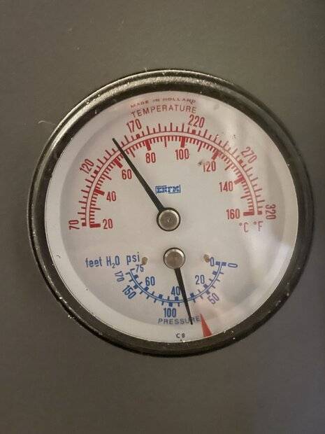

I have a two-story house with a 30-year-old water boiler rated for a max of 40 PSI. When the system is cold it rests at about 18-20 PSI and when fully hot it sits around 30-32 PSI. I had a tech come and take a look because I read somewhere PSI should be around 15. The tech said my gauge might just be faulty. Said even if too high it will just trip the pressure valve. Said it should trip around 30 and I said I never saw any evidence of water and that was why he thought the gauge might be faulty because I did have the valve replaced a few years ago but never tested. Anyway, the tech didn't seem too bothered but it's making me paranoid. I bled a mixing bowl of water out of a radiator and the pressure didn't drop noticeably maybe I need to drain much more or maybe the tech is right and the gauge is all wrong. Anyway, maybe time for a second opinion?

I would first verify how off the gauge is, if the needle is moving at all.
Many old gauges get stuck in one extreme position.
It moves from about 20 when cold to 30+ when hot, not stuck.

Nice video @Spinnor! I tapped the expansion tank and it appears to sound like it should if working. My release valve is set to 30 psi but not water seen.
I took a photo of my pressure gauge this morning.

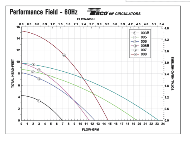

A typical circulator pump performance is curve 5 below,
My circulator pump is on the inlet side of the furnace, normally it is on the supply side. With the pump on the inlet side and flow rate set low by the furnace flow valve you could add 4 psi to your system pressure when the circulator turns on. That is only a small amount of your over-pressure, likely not the issue.

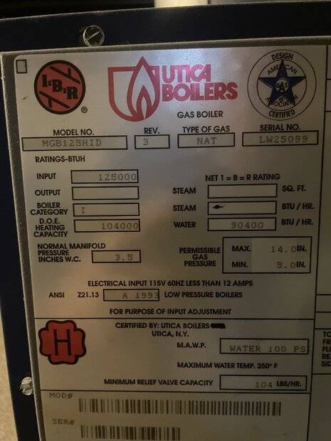

Ehh, kinda. The system is designed for what is needed to do its job, which is 30psi. The safety relief valve set pressure is 40psi because 'why bother setting it higher'. The system will not fail if the pressure goes up to 45 psi and the SRV doesn't open. The difference in "safety" is negligible unless your system operates near its maximum allowable pressure, which is not the design pressure.
Your boiler nameplate says its maximum allowable working pressure is 100 psi and the lowest rating I'm familiar with for piping and fittings is 125 psi. So while it is technically true that higher than necessary pressure can cause early failure, 35psi is way, way below what the system is likely capable.
