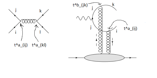

Consider the process in the picture below where an ##r \bar r## state goes to an ##r \bar r## state through mediation of a gluon. The gluon may carry the colour anticolour combination ##r \bar r##. I'm just wondering...
1) Can we have a gluon with the colour assignments just ##r \bar r##? If not, why not and if so, which of the eight combinations usually given in textbooks does it correspond to?
My thoughts are: when we speak of colour singlet states, what we really mean is the state has colour configuration ##1/\sqrt{3}(r \bar r + g \bar g + b \bar b)##. So should I think of the incoming r rbar pair on the lhs of my diagram to be simultaneously including the case where we have b bar and g gbar so that we identify the intermediate gluon as the one synonomous with ##(r \bar r - b\bar b -2g \bar g)##?

Ok, I'll rephrase my question - I've seen in the literature a vertex of the form qqG where the q's carry the colour quantum number ##r## and the gluon G carries ##(r \bar r - g \bar g)##. This made sense at first because there is no net colour into a vertex (red in, red out from the quarks and the gluon carries red antired e.g) but
1) Gluons are always in the colour octet representation and the vertex here shows that its coupling to the quarks did not change its colours. So the gluon being in the octet rep seems to be contradictory here, no?
2) In this vertex, can the gluon be chosen to be in the state ##r \bar r - g \bar g - 2 b \bar b## which is another of the eight allowed gluons with net colour out zero?

If your initial state (and final state) is supposed to be a color singlet, there can't be single gluon exchange, because the gluon is an octet. If you do this with the real color indices (and not shorthands like r, b and g), this will pop out of the calculation.
Thanks for the responses! @Orodruin @Vanadium 50 I'd like to understand the colour constraints more at the level of the group structure that you mentioned in your posts - I put some diagrams in an attachment. On the left I show a single gluon exchange diagram and on the right a double one. I want to see through the feynman rules that indeed the left one does not permit colour singlet state in both initial and final and that the right one does.
On the left I show what I think are the relevant factors attached to the vertices - we have ##t^a_{ij} t^b_{kl} \delta^{ab} = t^a_{ij} t^a_{kl}##.
On the right, basically I am thinking of a process where by a proton comes in, spits out a gluon that enters some hard interaction then a gluon reenters to ensure no colour break up of the proton, and the proton is therefore still in a colour singlet state. (Otherwise it breaks up, leading to DIS type events which I don't want to consider here). The net vertex factors are ##t^a_{ij} t^b_{jk} = (t^a t^b)_{ik}##.
How to show that in the right case, I can arrange for the proton to be in a colour singlet state but in the left the initial and final states may not be? For the left diagram, a colour neutral state would be the hybrid of rrbar+bbbar+ggbar so I could demand, say that ##i=j## and ##k=l## and get a net factor of ##(\text{Tr}(t^a))^2## which is indeed zero but my problem is, ##i,j,k,l## are all fundamental representation indices so setting i=j, k=l doesn't seem to account for the fact that I want the initial state to be a antired, red say. It only implies red,red, no?

There is no ##r\bar r## gluon. The gluon carries an 8 representation of SU(3) and color needs to be conserved at each vertex. If your in-state is color neutral - it transforms under the trivial representation (1) of SU(3) and therefore the color neutral state you started with cannot couple to a single gluon in the way you have depicted. The situation is generally more involved than just labelling each quark line with a color and every gluon line with a color and an anti-color.
I see - so essentially the intuition behind why a single gluon exchange cannot mediate two colour neutral states is that we have an initial colour singlet state coupling to a colour octet. So there is no way to end up with a singlet in the final state too. OK?
Also, in general why is there no ##r \bar r## gluon? It's one of the 8 gluons is it not? (i.e it appears in the combinations ##r \bar r - g \bar g## and ##r \bar r + g \bar g - 2b \bar b## which are two of the eight orthogonal combinations?
You cannot make a pure ##r\bar r## from those combinations. The 8 representation is traceless.

You cannot do this. The color neutral state is ##r\bar r + g\bar g + b\bar b##. It is like saying that you pick the x-component of a vector to represent it.
CAF123 said:
The only way to mediate between two colour neutral states in the tree like configuration shown is via a photon. Is it ok?
Or anything else that is color neutral - like a Z boson. Note that you could also mediate the interaction at loop level with two gluons. The intermediate state would be part of an ##8\otimes 8## representation that includes a color singlet when split into irreps.

No! The expression ##\bar{\psi} T^{a} \psi## represents 8 components of a "color tensor" that transforms according to the octet representation of color SU(3) transformations. That's why you can contract it with the gluon field in the Lagrangian which consists of color-singlet (neutral) expressions as it must be to fulfill gauge symmetry.

No, it's already clear from the notation that ##\bar{\psi} T^a \psi## is not a singlet, because there's a free colour index ##a## in that expression. By definition of what's called the adjoint representation of SU(3) it transforms under SU(3) according to the adjoint representation. That's easy to see. The adjoint representation (which is 8-dimensional since you have 8 generators ##T^a##) is defined by
$$T^{'a} = \hat{U}^{\dagger} T^a \hat{U}=U_{\text{ad}}^{ab} T^b,$$
where ##\hat{U}## are the matrices of the fundamental representation. The ##8 \times 8## matrices ##U_{\text{ad}}^{ab}## define the adjoint representation of SU(3). Now since
$$\psi'=\hat{U} \psi, \quad \bar{\psi}'=\bar{\psi} \hat{U}^{\dagger},$$
it's clear that ##\bar{\psi} T^a \psi## transforms according to the adjoint representation.
