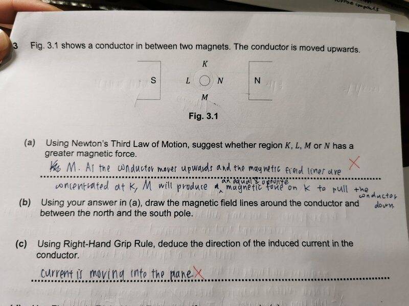

using newton's third law of motion, suggest whether region K,L,M, or N has a greater magnetic force
nil
I feel that its M because as the conductor moves upwards, towards K, an equal but opposite force will be produced at M to pull the conductor downwards, but answer is K.
We are told that the conductor is moving up. According to Lenz's law, the induced current would be directed in such a way as to oppose the motion. For part (a) we don't need to know the direction of the motion but we do know that the force will be directed down, opposite to the motion.
Now imagine that the conductor is moving up with constant velocity being pushed by a hand. When that happens, the hand force is up, the field force is down and the two have equal magnitudes and opposite directions according to the 3rd law.
It looks like you missed the Lenz's law justification for the direction of the induced force on the conductor. This is a case of magnetic braking. If the current flowed in the opposite direction and assisted the motion of the conductor, then it would accelerate forever and have a source of abundant cheap energy.
