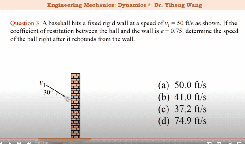

Vladimir_Kitanov
44
V1=50 ft/m
e = 0,75
e=(relative velocity after collision)/(relative velocity before collision)
Last post with picture, after this i will use Latex.
She say that correct answer is 41 ft/m.
Is this correct?
I get answer b). ##41 \ ft/m##
The coefficient of restitution applies only to the normal velocity component.
PS effectively you just multiplied 50 by 0.75.
