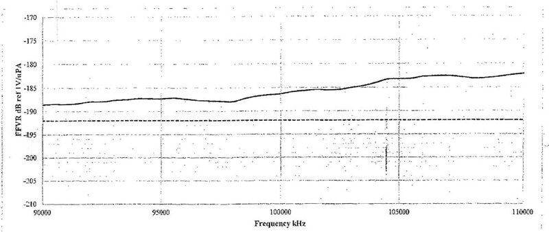

Hi all
I have an acoustic piezoelectric sensor whose output impedance should be ideally 50 ohm and a preamplifier circuit specifically designed for this sensor having input impedance of 50 Ohm. The piezoelectric sensor output voltage range is from uVrms to few mVrm. These low voltage signals are then amplified by preamplifier.
My query is that if there is a mismatch b/w output impedance of sensor and input impedance of preamplifier, what will be the side effects? In case of Transmission chain, it is obvious that such mismatch (e.g. b/w Power Amplifier and Transducer) causes power losses, however, what will happen in case of receiver chain when very low voltage signals are present ?

Thanks for reply. Both transducer and preamplifier are own developed and are not COTs. Controlling the output impedance of acoustic transducer is quite challenging and main impedance deviation is in output impedance of transducer (>67 ohm instead of around 50 ohm).
Do you have gain/phase plots of the transfer function from an acoustic driver through the (liquid?) medium to the output of the transducer? What is the frequency range of operation? Can you post a PDF or JPEG image of that gain/phase plot?
Likes DaveE
Frequency range of operation is from 90 KHz to 110 KHz.
As transducer is being used only in receiving mode (i.e. as a hydrophone), there is receive sensitivity vs frequency graph available indicating how much voltage will be generated at transducer output for standard input of 1upa sound pressure in water for a typical frequency range. If you are interested in this graph, i can post it.
Great, that would be helpful. And have you also measured that same transfer function to the output of the preamp? That might start to show you if the impedance mismatch makes much of a difference.
It looks like your plot is centered on 100MHz, not 100kHz. Am I misreading something?
Sorry, frequency axis label is misleading (i.e. should be Hz instead of KHz), sensor is certainly centered at 100KHz
Likes berkeman
