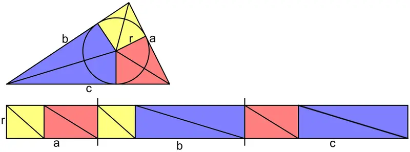

Antoha1
in a triangle,is the angle between the points of contact of the inscribed circle with the sides 120 degrees? From drawings it might be similar to that but I am not sure
Mathematics news on Phys.org
Consider the case of a right triangle.
Von Mabit1 - Eigenes Werk, CC BY-SA 4.0, https://commons.wikimedia.org/w/index.php?curid=127735873
Imagine the blue angle would be 30°. Which angle is then at the blue center?
