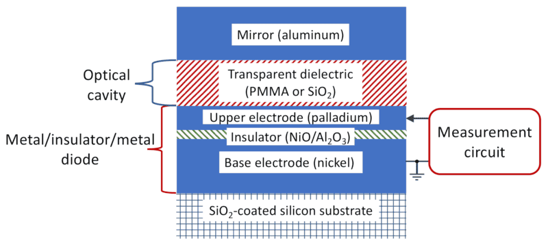

Really fascinating and interesting experiment. There's a fantastic video for those interested where he goes more in depth comparing different variations of quantum theory and they might explain it, but I'll give the basic overview here as I understand it quickly to give some preface to my question. Please note I am seriously not an expert in this at all and may be totally off. Reference the above picture.
  1. The Casimir Cavity/Optical Cavity (~30nm thick) essentially blocks all wavelengths > 30nm in the transparent dielectric (I know it's about harmonic resonance but let's just keep it simple for now).
  2. The upper electrode (palladium) is 2nm thick. The insulator below is also 2nm thick.
  3. According to Heisenberg's uncertainty principle, high energy quantum fluctuations in the form of photons can exist for a very short time. A particle travelling at the speed of light can exist therefore exist for a very small distance (in this case, 2nm is enough distance for a UV photon to cross, I believe - I might be off about this exactly).
  4. The upper electrode cannot support >30nm wavelengths due to the casimir cavity on top of it blocking them from coming through from above. As well, the electrode is too thin for them to appear within the conductor. Whereas the base electrode can create them because it's quite a bit thicker. This creates asymmetry across the insulator as more spectrum can be created in the base electrode versus the upper electrode.
  5. Wavelengths > 30nm "cross" the insulator from the base electrode and exciting electrons in the upper electrode.
  6. Assuming Moddel (if I understand correctly) puts forth this idea whereby a virtual photon can become real under a certain condition (related to frustrated total internal reflection), to account for the possibility that quantum fluctuations are virtual. Essentially, when a real photon is reflected internally, there is a virtual photon probability wave that emanates on the other side of the point of reflection, which goes outward and can collapse where it meets another thicker medium. This probability wave expands (I think similar to quantum tunnelling), and can be converted into a real photon. So his idea is that this "conversion" process might be happening at the boundary of the insulator and the upper electrode, where virtual quantum fluctuations are being "converted" to real photons.
  7. All of this creates an electrical circuit via the photoelectric effect.
(Note: I believe electrons are re-introduced into the upper electrode via quantum tunnelling from the base one but that's a bit beyond me)

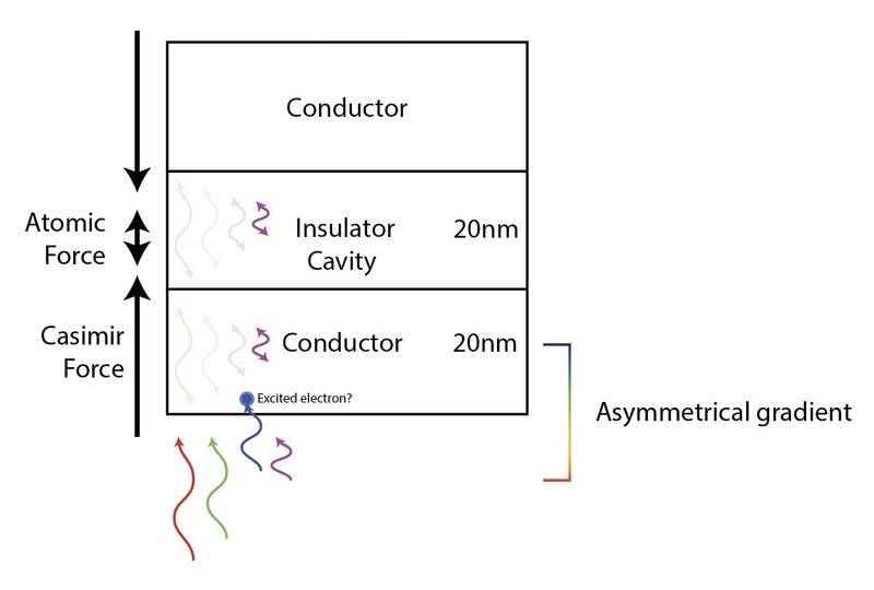

My question, topic of discussion:​
So as far as I know, and I know very little, the casimir effect is essentially caused by the "pressure" of quantum fluctuation. This is all I can really find out about it without going really deep into the math which is beyond me (I am practicing!). But what exactly is pressure? I really tried to dig this up but couldn't really get to the bottom of it. In classical physics pressure is excitation of atoms and molecules smashing against something. Obviously classical physics doesn't really translate into the quantum world generally. But what is the equivalent explanation for virtual particles creating real effects?
As I understand it, quantum fluctuations were seen as being virtual for the longest time. Yet, the Casimir effect shows that they do indeed have a real effect. How can something virtual have a real effect? I have been trying to follow the logic of how exactly the mechanism of this works. How is something virtual "translated" into a real effect?
Is it possible that it isn't virtual at all? Maybe the force is symmetrical everywhere and in everything in all directions such that the net effect is 0 on everything from a practical perspective, and so we just call it virtual? Since in nature it's incredibly rare for quantum fluctuation asymmetry to be created spontaneously, we just assume it's virtual? If two people push on a box from both sides, they equalise it and so there is net 0 effect. Does that make their pushing virtual? I would say not.
Nevertheless, I wonder whether that's actually the case. Is it possible that quantum fluctuation photons are actually real photons?
If this were true, then we could create the following experiment. Basically we remove altogether the insulator and metal at the bottom. Now we have just a casimir cavity except using an insulator instead of a vacuum. The difference is, in this casimir cavity, the base plate is extremely thin. Let's say 20nm. This way anything above 20nm wavelength won't be created within it, therefore creating asymmetry. I haven't looked it up, but is it possible what I'm about to say has never been observed because the parallel plates were always quite big?
If the conductor is too thick, there won't be asymmetry in the high-energy photon range. But if it's 20mm, maybe these photons would excite electrons in the conductor via the photoelectric effect. But where would the electrons go? They would need an opposite charge to create current. Maybe, maybe, nobody ever bothered to create something like this, let alone measure it. Because how do we measure it? There's no circuit like there is in Garret's experiment.

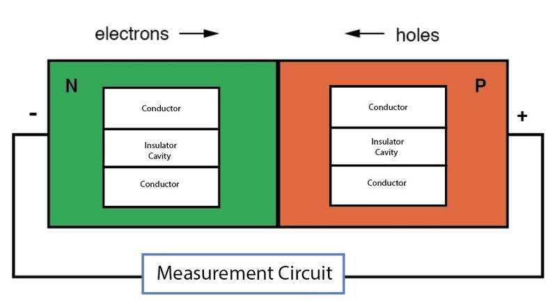

What if we can use a P-N junction with two of these to create current similar to how solar panels work:
I'm 99% sure this is just fantasy and represents my very very little knowledge on the subject. But the thing for me is that I don't really know why it won't work, because I don't understand how the casimir force is actually being created. And explanations I've found have left me unsatisfied. What explains Moddel's findings while still being aligned with the idea of it being virtual? The question ultimately for me is what exactly is pushing the conductors together? If photons are real enough to create current in Moddel's experiment, real enough to push two plates together, yet still not real, what would prevent them from creating current in this one?
To anyone with the patience to give this some thought and reply - thank you!

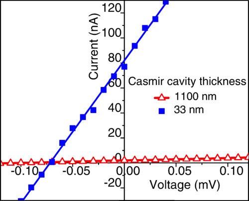

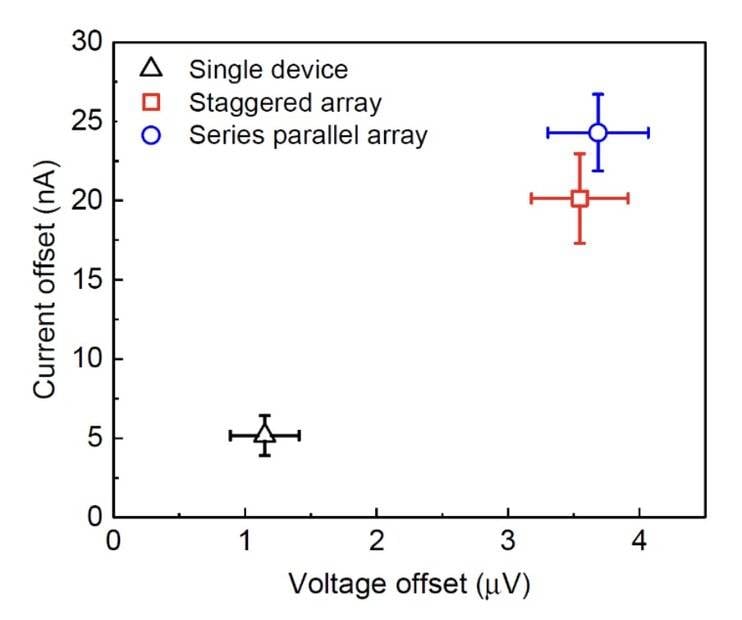

It seems to be the case yes. Here is the portion of the text and the attached figure:
In addition to the changes in resistance reported here, a small anomalous offset current and voltage were observed in the Casimir photoinjector devices. This can be seen in Fig. 5 [[[[ picture below ]]]], which shows the low voltage range of the devices presented in Fig. 3(a). With the base electrode as ground, a positive current flows from the upper electrode to the base electrode at 0 V. If we assume that ZPFs cannot be the power source, an external voltage source would be needed. As described in the Supplemental Material [39], we carried out extensive experiments aimed at eliminating this offset, including developing an improved method for measuring low-current electrical characteristics, recalibrating instrumentation, producing temperature gradients to check for thermoelectric effects, making arrays to check that the voltage and current offsets scaled with the respective number of devices in series and in parallel (they did), investigating whether the voltage and current offsets might be transient and possibly a result of hysteresis during measurement (the currents are stable over a period of hours with no externally supplied power), and making sure that the devices are blocked completely from any stray light during measurement. Thus far, we have been unsuccessful in finding an artifact that would explain the anomaly. These offsets are small compared with the voltage and current ranges used to measure the differential conductance values and therefore do not affect those measurements. We describe these currents and voltages in more detail in a separate publication [49].
(b) the actual best current theory we have about such experiments (which is much more nuanced and complex than the simplistic picture you give).
Yes I'm aware that my picture is simplistic, which is why I'm not claiming that it works but wondering why it wouldn't in order to further my understanding of QM. My question is, given that in the above paper, there seems to be power generation, why wouldn't it be the case that a simple Casimir cavity with an ultra-thin conductor would not produce the same kind of photoinjection effect as in the paper?
I have no idea which theory of QM would support this, which is why I'm putting the question forward. I do appreciate that QM is counter-intuitive. It would also be cool I think to start a conversation and see how the bright minds here can maybe put their heads together and see what theory(s) fit with these findings.
Thank you for the links, I will read all of them. 👍
If the voltage between the upper electrode and the base is zero volts, then zero energy is being transferred by the observed current. This is already known to be the case for other materials, such as superconductors, in which a nonzero current can be sustained indefinitely with no energy input--but which also transfers no energy.
I don't know if anyone has investigated possible similarities between the device described in this experiment and superconductors, but that would seem to me to be an avenue that should be explored.
I don't think the X axis on the graph is showing the voltage output of the device (between the upper electrode and base), rather it's describing the voltage being applied to "counteract" the device. So when 0V is applied externally to it, the current flowing through the circuit is ~80nA. You have to apply 0.07mV against the device to make the current drop to 0. This implies that the device itself is generating power (kind of like pushing against a battery is how I imagine it).
I don't know what you mean by this. The voltage is being measured, not applied; it is the measured voltage between the upper and the base electrode. See the "Measurement circuit" shown in Fig. 1.

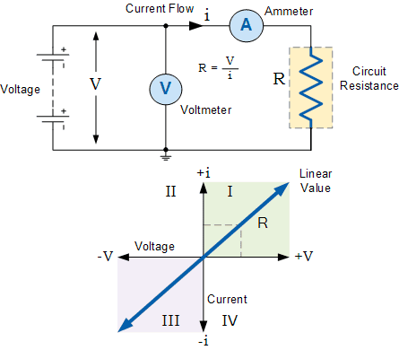

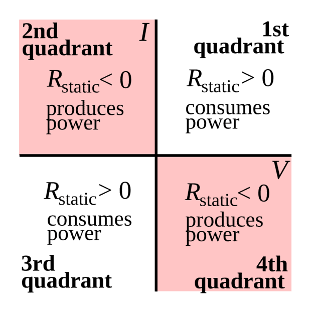

It's a current-voltage characteristic graph, I believe the measurement circuit is just showing where the device is located. Here is an excerpt from wikipedia on a current-voltage characteristic:
Active vs passive: Devices which have I–V curves which are limited to the first and third quadrants of the I–V plane, passing through the origin, are passive components (loads), that consume electric power from the circuit. Examples are resistors and electric motors. Conventional current always flows through these devices in the direction of the electric field, from the positive voltage terminal to the negative, so the charges lose potential energy in the device, which is converted to heat or some other form of energy.
In contrast, devices with I–V curves which pass through the second or fourth quadrants are active components, power sources, which can produce electric power. Examples are batteries and generators. When it is operating in the second or fourth quadrant, current is forced to flow through the device from the negative to the positive voltage terminal, against the opposing force of the electric field, so the electric charges are gaining potential energy. Thus the device is converting some other form of energy into electric energy.

No. The paper explicitly says that the upper electrode is illuminated to produce what it calls "hot carriers". In other words, it is making use of the photoelectric effect.
Again I don't know what you mean. The measurement circuit in Fig. 1 explictly shows an electrical ground at the base electrode and an arrow giving the direction of positive current.
It shares some aspects of one, but I'm not sure it's that simple.
Even with the simple picture given in the Wikipedia article, however, it is evident that points anywhere on the axes (which the zero voltage point described in the paper is) have zero power--they are neither producing nor consuming power. Which is consistent with what I said in my previous post, that zero energy is being transferred.
Oh yes, well that's his theory on what seems most likely to be producing the energy. That essentially the casimir cavity creates an imbalance of quantum fluctuations, and the repression of certain wavelengths on one side of the insulator creates what I might describe as a quantum fluctuation asymmetry, but only virtual asymmetry. The boundary between the insulator and upper electrode 'captures' or converts virtual photons to real photons in a way similar to frustrated total internal reflection (essentially tunnelling, as I understand it). Leading then to the photoelectric effect.
I think this is a really good pre-discussion topic because I-V curves can be a bit counter-intuitive. We definitely do need to be clear about the findings before we can discuss anything else, so let's go into the circuitry involved.
The paper considers the device under investigation from a resistance-measuring perspective, treating it as a resistor. To test a resistor, one usually applies a voltage source to it and plots the resultant current against this applied voltage. The following standard measurement circuit for testing a resistor serves as a good example:
source
Page 4 in the supplementary material of the paper talks more in detail about the electrical measurements and mentioned that they used four point probe configuration. This is what they are referring to by "measurement circuit" in Fig 1. Here is a video describing why this technique is necessary for tiny values (to negate the small effects of ammeter/voltmeter).

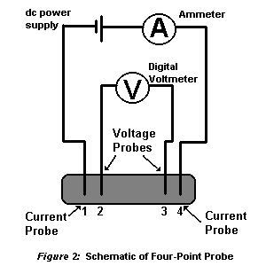

Below is the standard measurement circuit for a I-V curve using the four point probe technique. Also note that the voltage is being applied from the measurement circuit itself, in this case via a power supply. Measurements of current are being plotted based on voltage (changing the power supply).
(note that in the case of the device in question there is also a ground added)
When using I-V curves to measure a resistor, the line is expected to pass through the origin (V=0, A=0). However, when it doesn't pass through the origin, you get an X-intercept and Y-intercept:
  • The "open-circuit voltage" (Voc) (the voltage when no current is flowing I=0)
  • The "short-circuit current" (Isc), (the current that flows when there's no voltage drop across the device V=0).
This is because the device is generating the electrical power rather than an external voltage source driving the current.
It might be counter-intuitive that a voltmeter can read V=0 while current is running through it, but keep in mind this is because it's a short-circuit condition. In a short-circuit condition, the voltmeter will read 0 simply because all of the current is taking the path of no resistance, bypassing the voltmeter. Although it might seem that if V=0, then P=VI implies there's no energy, this isn't correct. Consider a battery. Short-circuit a battery and place a voltmeter in parallel and it will drop to 0. Doesn't mean the battery doesn't produce energy. The actual power generation is demonstrated by the curve of the IV graph passing through the 2nd quadrant.

Second,
This is a IV curve plotted against an externally applied voltage, and when the voltage is -0.07mv, the current stops. You can even ignore the V=0 point, due to the fact that on both sides of the graph where V>0 and V<0, there are points that show a positive current (really the negative is the only meaningful one, because a resistor would still be plotted on the positive side).
Furthermore, the X-intercept (V=0.08mv, I=0) is just as important as the Y intercept where (V=0, I=0.80nA). I'm not sure if you read my explanation on how four point probe IV curves work, because I wrote a pretty in-depth explanation there.
I don't claim to know anything that's going on at the quantum level, but the electrical stuff I can definitely speak to with a fair amount of confidence. You can actually do a power calculation from a linear IV curve as follows to calculate its peak energy:
The "open-circuit voltage" (Voc) = 0.07mV (<--- external voltage required to "stop" the current from flowing)
The "short-circuit current" (Isc) = 80nA (<--- current that flows in a short circuit condition)
Using a simple P=IV calculation (which does apply in this situation): 0.07mV * 80nA = 5.25 picowatts
And this is for a device that's 300nm x 250nm, assuming linear scaling that's roughly 65W/m^2

  • #33
Where in the paper does it say there is an externally applied voltage? Be specific.

I've created a visual to explain this using the figure in the paper. Note how the green line passes through the origin when V=0. This is how a non-power generating device behaves. In our case, there is a positive current even when V is negative.
Again, it's not so much the I > 0 when V = 0, it's that there are data points within the 2nd quadrant, demonstrating that there is positive current when external voltage is applied against the flow of current.

peterbb said:
If you read the first two paragraphs it places things in context. There is no external light source.
I have read these repeatedly and I'm not getting that. I'm getting that there is an external light source. But even if I am wrong and you are correct, that's still not the primary issue. See below.
peterbb said:
With a non-power generating resistor, you expect the line to go through the origin.
No, with a completely dissipating resistor, you expect the line to go through the origin. In other words, a resistor does not convert any input power into current. Apparently the devices used in this experiment do. But that doesn't mean they are generating power from nowhere. They are generating power, if they are doing so at all, from the input provided by the power supply. With no power supply hooked up, the thing just sits there and doesn't generate anything. At least, that would be my expectation--but the people who ran this experiment did not even think of running this obvious control experiment.
To really test what these experimenters are claiming to test, you would hook up a circuit to the device containing a tiny load, with voltage and current measurements attached to the load (or part of the load), but with no power supply at all, and see what happens. A device that can actually generate power "from the vacuum" would show a nonzero voltage and current under such conditions, which the load would use for whatever it does. I predict that the devices in this experiment would do no such thing. But in any case this is an obvious thing to do which these experimenters did not do. Again, that makes me highly skeptical that they are showing a real effect, rather than an artifact of the fact that their experimental setup contains a power supply.
